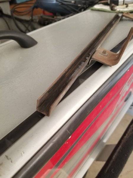

Inside the drivers door the vertical window track is missing what I think is called "Cat whiskers"..when you shut the door the window rattles in there a bit.
Looking to replace the cat whiskers inside that track.
Anyone know of where that material can be found or a suitable modification if they dont make it any more?

I went to a fabric store and matched it up, like khryslerkid said, its just a felt type of material.

Classic Ind MD8067 41-76 MOHAIR LINER 1-5/8 for $24.99 Window seem very tight when I test it but have not install window to try out yet getting close.
I bought mine ( window guide felts) from Detroit Muscle, not cheap by any means @100 ea and are fairly delicate. The felt is on a very thin piece of ABS type plastic that is easily split. They did tighten up the window and work very well. I just dont know if they make them for 63, I think they said 66-70
Just a suggestion when installing...you have to make your own holes for the guides. Use a hole punch and do not try to drill them, I almost ruined mine
I bought mine from Joe Suchy, used Goop to glue it in, rolling it in with a window screen roller. Then jammed in a strip of 1/4" plywood until the Goop set up. Worked nicely.

The actual material is mohair channel liner and comes in two different widths, 1-5/8 or 2-7/8 inch. Pricing for the thinner material is typically around $2.50 per foot for the thinner width and $3.00 for the wider material. It will take seven feet for a hardtop and eleven feet for a sedan. As others have stated, it basically resembles a velcro type material to me. Just glues in the track with weatherstrip adhesive.
