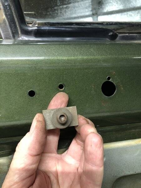

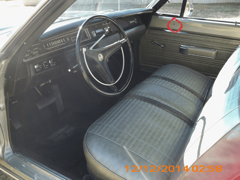

Circled the rubber grommet it is behind in red. Both bolts on the backside of door, that allen inside that hole, and then I believe the bolt through the bottom of the door and it should slide free. I think there's a nut you can remove on the top of the stud down inside the door to free the bottom as well, but when I did mine I loosened the whole stud by mistake.....end result was the same. Also watch, there is a theaded block of metal (crude nut) behind that allen that will fall when it is screwed out and you can grab it inside the door where it falls or wiggle your hand back behind it and hold it.
Thanks RT yup here is the hex bolt with the companion nut. Never would have seen this! Thanks man!
Yup no problem......my buddy told me of that allen bolt a few years back or I would have never known either. Don't lose that rubber plug/grommet as they don't reproduce them to my knowledge.

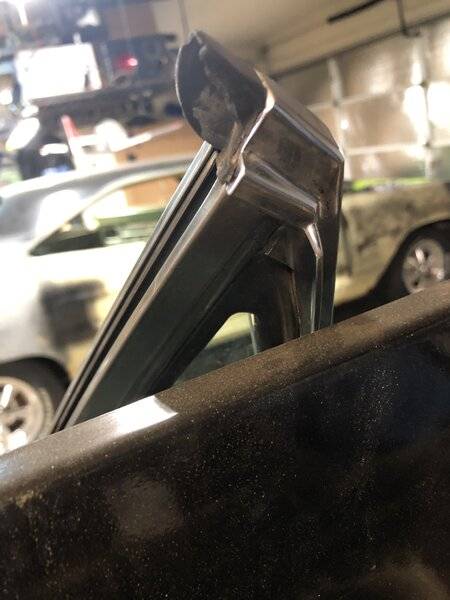

Ok stepping back for a bit. Can’t seem to free the wing. I don’t want to force it and break anything. Is there a wiggle trick to this? I can’t wait to put this all back together lol I did loosen the wain window.
EFB4E2DF-BD5A-4730-97E6-B418AAD4C318.jpeg 1215CF6D-2C9E-4196-A363-A880E1FFD722.jpeg
Looks like the main window needs to come out first. I’ll try that.

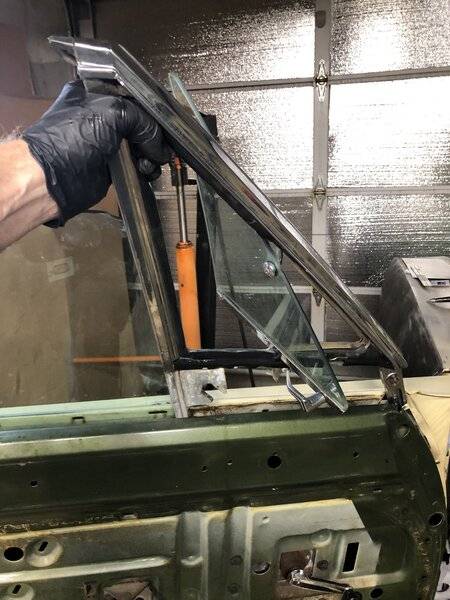

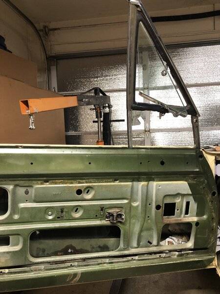

Welp door is free of all glass now. Main window had to come out with the wing window due to the keeper tip in the wing window which prevents the main window from coming out. Not sure if dismantling the wing tip here would be wise so I just pulled both windows simultaneously.

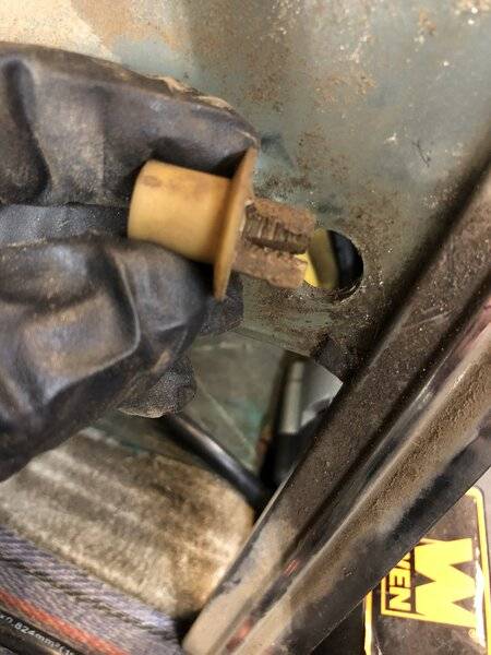

I hope they still produce this plastic stud as mine was very brittle.
Great to see you so active on the car! Yup at the same time is the easiest. I am not sure if those are reproduced. Save all the pieces may have to save it!

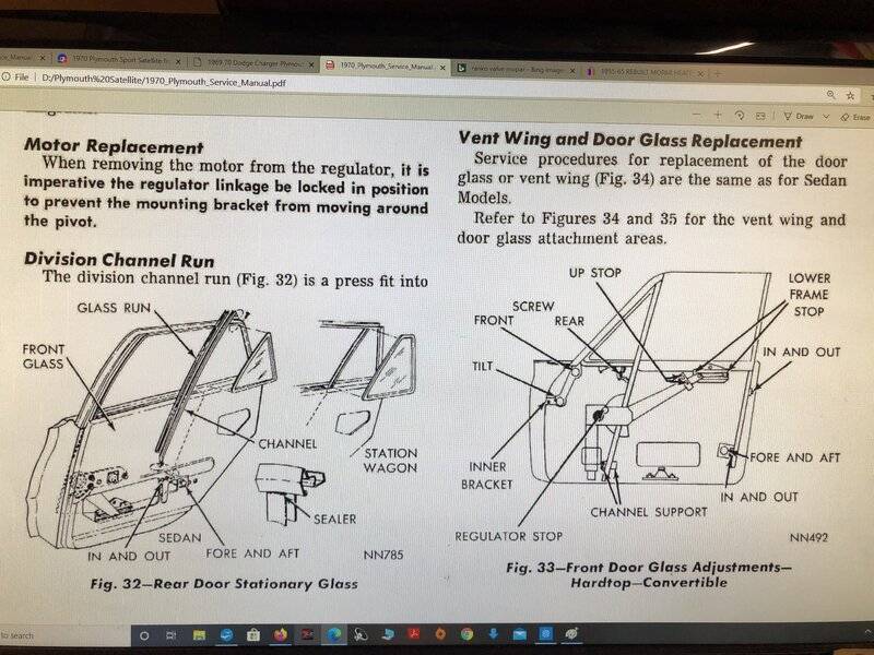

there is a picture in the Service Manual, but it shows the assembly in an upside down view.
