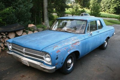

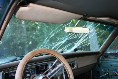

Storm damage to my 65 Belvedere. Tree branch clobbered the windshield. Gasket is still good (not the original one) and I have another windshield. Has anyone on the site ever replaced their own windshield? There is a method using rope that I am considering. Just wondering if anyone has any tips or such.

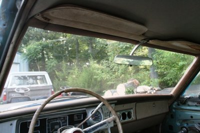

OK, per the suggestion, I gave it a try and the windshield is in. Old windshield was easy enough to push out as it was already broken. Soaped the daylights out of everything and with the help of a friend on the inside, squeezed and pushed the replacement in place. It actually went a lot smoother than I anticipated. Hardest part was the cleanup.
looks good cleaning the dish soap is always the hard part thanks for the pic

The tree also broke both of my wiper arms (spring inside broke). I fixed one with parts from my old Dodge Pickup. Should be enough to get through inspection. Now the fun part starts, swapping the /6 for a 400 Big block.
