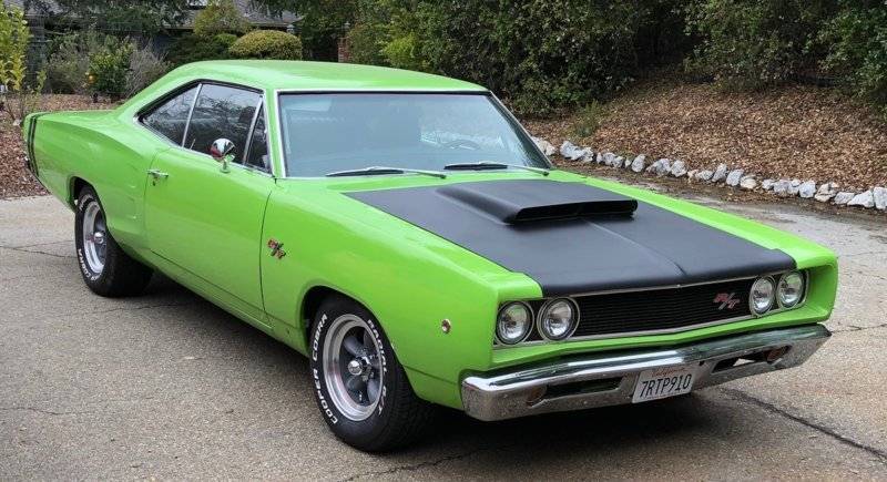

Hey Doug great looking car! What color is that?
