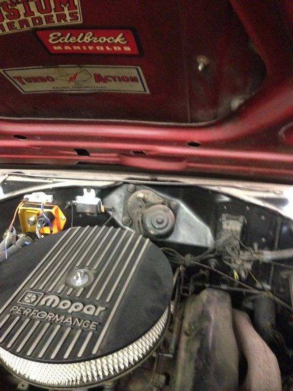

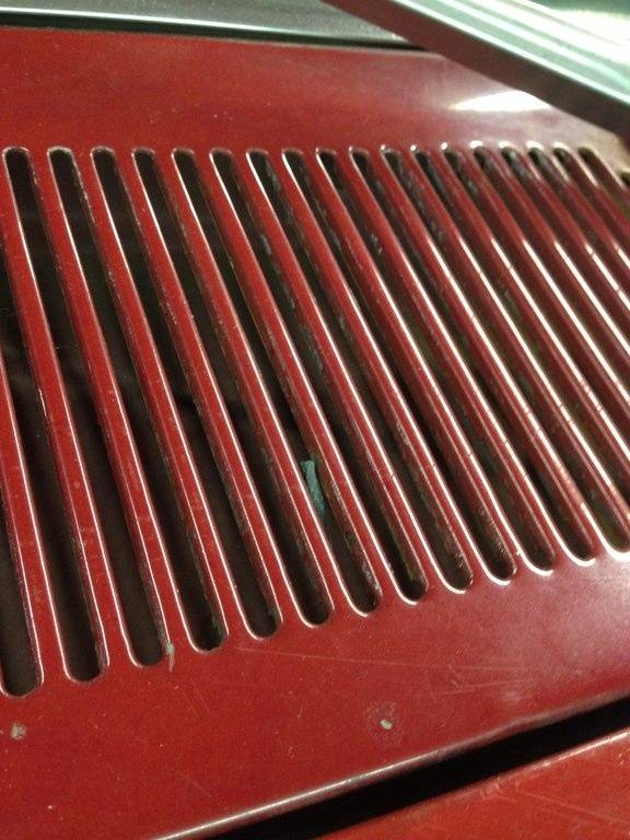

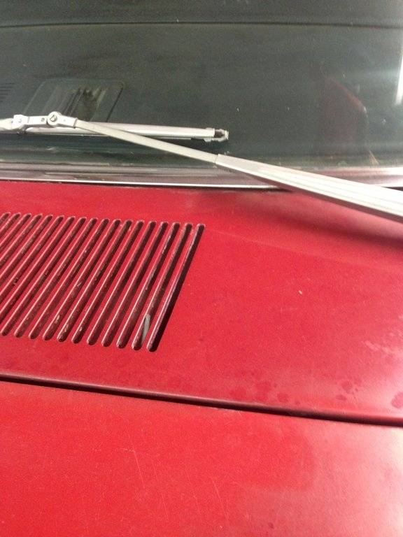

68-69 shouldn't be too much different.Rt side then left then underhood.
Now I've done it- old underhood stickers from the late 70's early 80's.!!!
