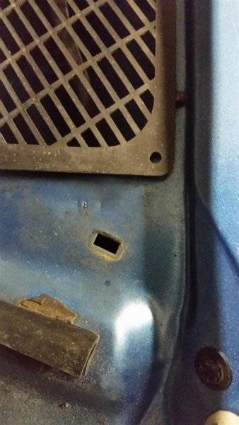

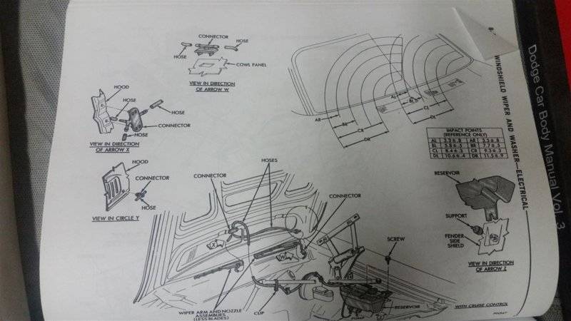

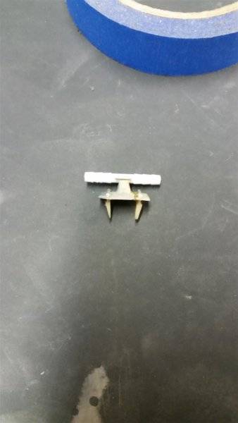

On my 74 Charger without cruise control. Has anyone seen a source for the windshield washing tubing connector shown in the factory drawing as "W" at top of page? One photo shows the rectangular hole on top of cowl where the connector mounts and the other photo shows my broken connector. Just trying to find a better one before I try to repair this one. This is the connector for the drivers side wiper with the squirter nozzle in the wiper arm. Thanks for any info.

rtspecialties.net is where I got mine. Tom Race he may have what you are looking for.
Thanks. I was on their store page and saw the F-style tubing connectors but not like what I have. Maybe I'm not using correct search words. I'll take another look. Again, thanks.

That's a 74 and lates piece only ( with and without CC )... those with washer squirters mounted on wiper arms. Same as the conector on hood, being Y shapped ( and white ) instead T ( and black ) like earliers
Go to a swimming pool parts house or a place
that sells pools.
I have a slide on my pool that has plastic connections
Tees etc.The tubing is plastic that you can easily
route any where you need it.
