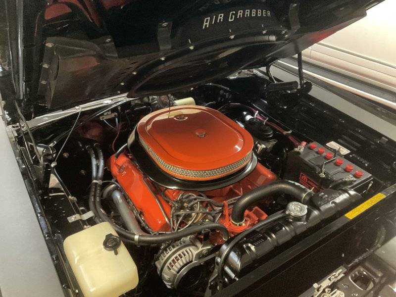

Winter Project - ‘69 GTX Engine Compartment Rehab
Underhood and trunk are done.
I also got most of the discoloration polished off the rear bumper.
Done for today…

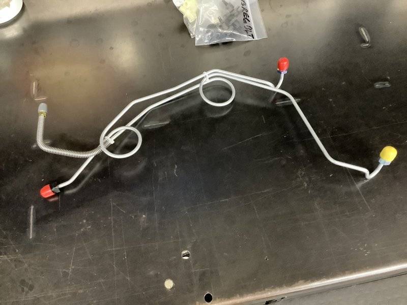

I purchased a set of reproduction brake lines for a power brake car to compensate for the 6” + depth of the hydro boost unit. Just eyeballing it, they will work perfectly. The supplied pressure hose looks to be on the short side, 4’ may not be enough to run from the ps pump to the booster and back to the steering gear while keeping the lines away from the headers. I’m sure our hydraulic shop can hook me up with custom hoses if that’s the case. The kit came with plenty of low pressure return hose but no clamps, hopefully I can find fuel injection clamps that will fit the OD of the hose.

The in-line tube brake lines needed to be re-bent in order to clear the inner fender well. Fortunately, they were pretty soft, and I was able to reconfigure them easily. I am at an impasse until I get some different fittings. The 90° fittings for the high-pressure hoses, supplied with the line kit our sub optimal. The inlet fitting is too close to the inner fender, and the 90° fitting for the outlet positions the line out into space. I ordered some 120° fittings from Summit, they should allow me to route the lines more neatly. While I am waiting for the fittings to show up, I need to figure out how to adapt the brake light switch because the clevis on the push rod is much narrower than the factory push rod.

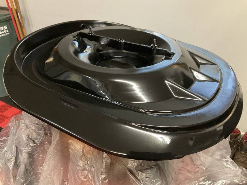

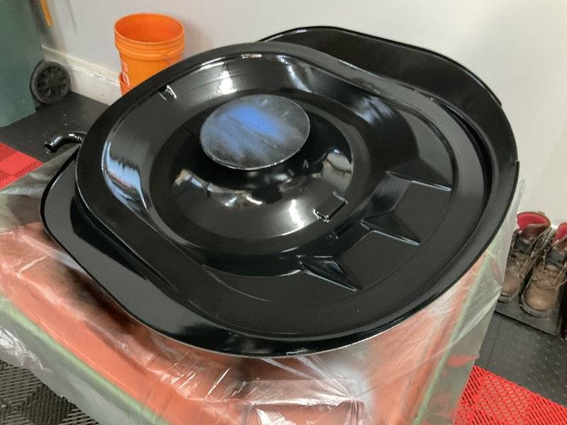

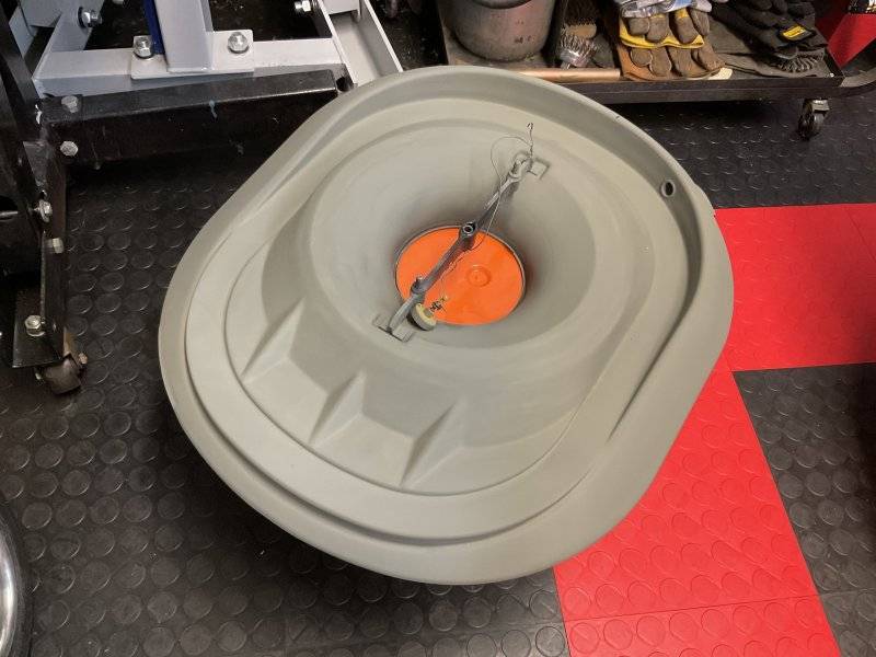

I wasn’t 100% happy with my AirGrabber baseplate because I painted it without addressing the rust pitting where the Air Grabber seal had previously rubbed the paint off. My first attempt didn’t go so well, I ended up stripping it to bare metal and starting over. I hit the pitted areas with a few coats of sanding primer and blocked it out before giving it a couple coats of etch primer.
After letting it sit overnight, I lightly scuffed the etch primer with a 800 grit scuff pad. After masking the carb opening to control overspray I gave the bottom side a tack coat of POL semi-gloss black enamel. When it flashed off I gave the underside a full wet coat.
When it was dry enough to handle I turned it over and wiped the top side with wax and grease remover followed by a tack cloth. The paint procedure was the same although the top side got a second full wet coat. I have to say, the POL spray paint lays down nicely. It’s a bit glossier than I wanted, although it’s flattening out a little bit as it dries.

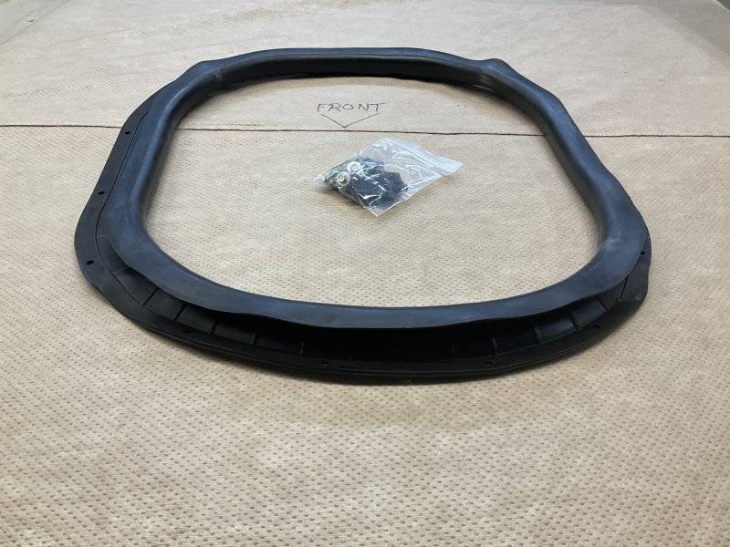

I’m going to resist the urge to put it back on the car right away, and set it aside for a few days so it can dry completely. In the meantime, I’m going to install a fresh Air Grabber seal from DMT. The current seal is a 25+ year old reproduction that’s beginning to show it’s age…
The gloss will deaden out some after a few heat cycles
Looking good though
