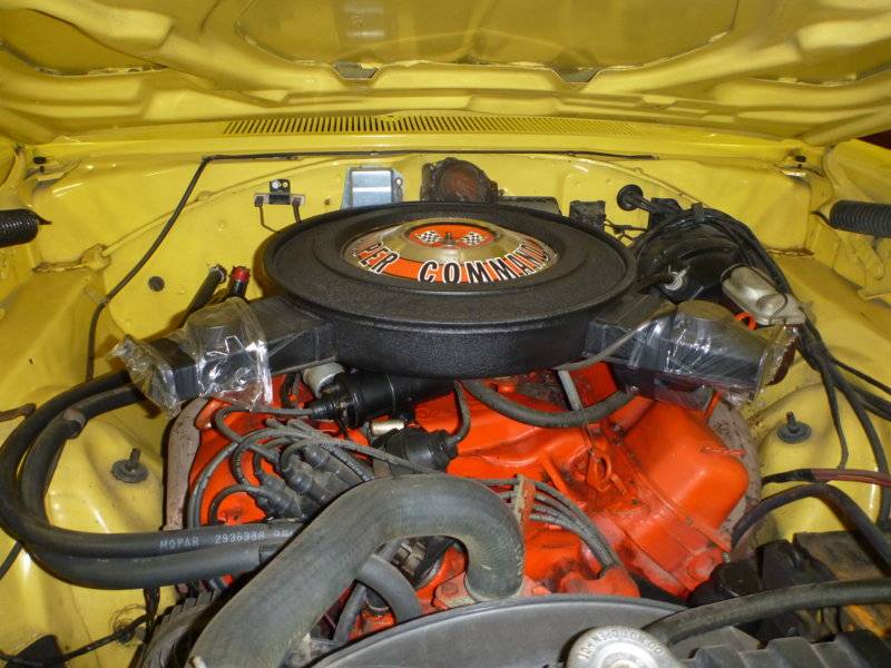

OK cool, thanks! How do I cap the Carb and Exhaust?
I just roll up socks and stick them in the tailpipe or you could use tape I suppose.
For the carb a piece of heavy plastic cut round and just pop it right over the air cleaner rod.
Set the air cleaner right back on top. Viola the air can't move through any cylinders with an open valve. Otherwise if you have a warmer day after it's been cold and you get air movement through an open cylinder you can get condensation inside the motor.
Just remember to remove this stuff before you fire it up in the spring...
If you have mice/rodent potential, using steel wool instead of socks will deter mice from chewing through. They won’t chew it. If you can, put the car on jack stands, fewer tire/flat spot issues.
:thumbsup:
