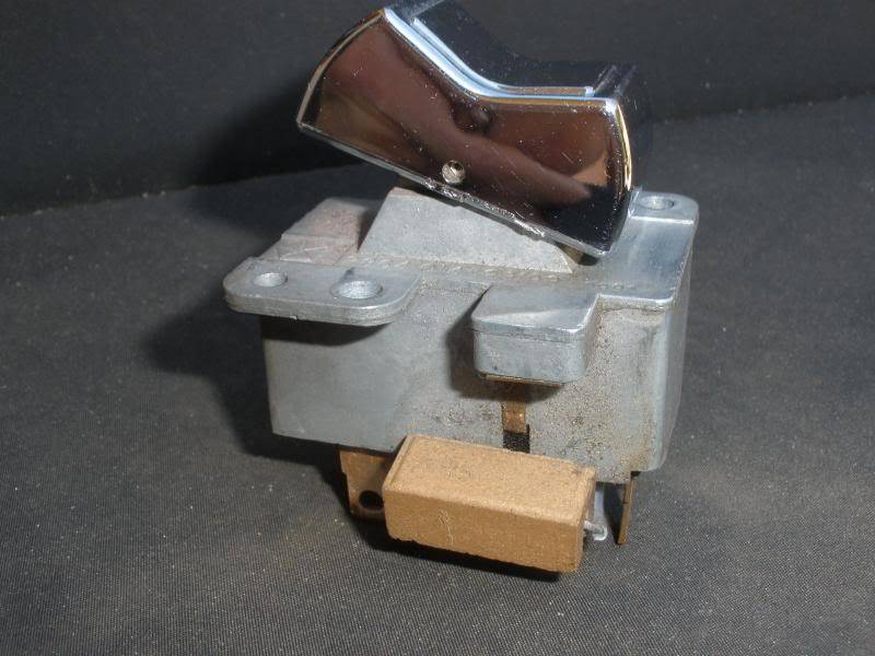

Do these switches have a resistor for lower speeds like the heater motor circuit?
Yes

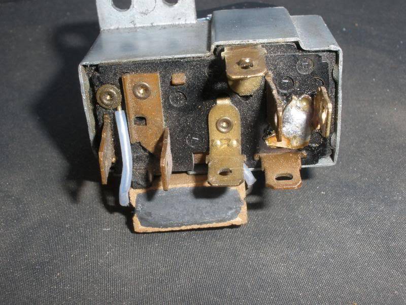

Thanks, but my switch is different to that. Haven't got a pic handy, but it's a round switch with no obvious resistor on it.
That switch pictured is from a 68-70 3-speed. The 73 2-speed wiper motor has the resistor on the motor not on the switch for the low speed. I have a correct 73 RR 2-speed switch in good used condition and also have a tested working both speeds and parking, wiper motor available, correct one for the concealed wipers. PM me if interested
