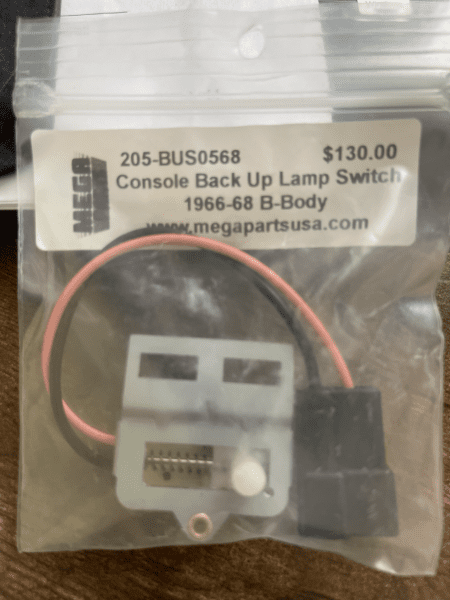

Is it a column shift or floor shift.
If it's a console shifter, this is the switch that's mounted inside the console to the shifter. I thought mine was dead, so bought a new switch, but then I realized the PO had not reinstalled the switch correctly. Cleaned my original up, and installed it correctly, and voila!, reverse lights.
