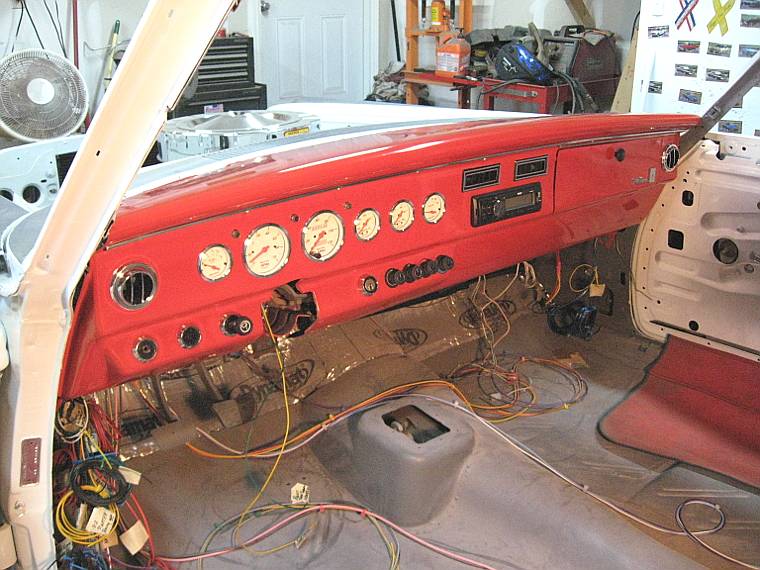

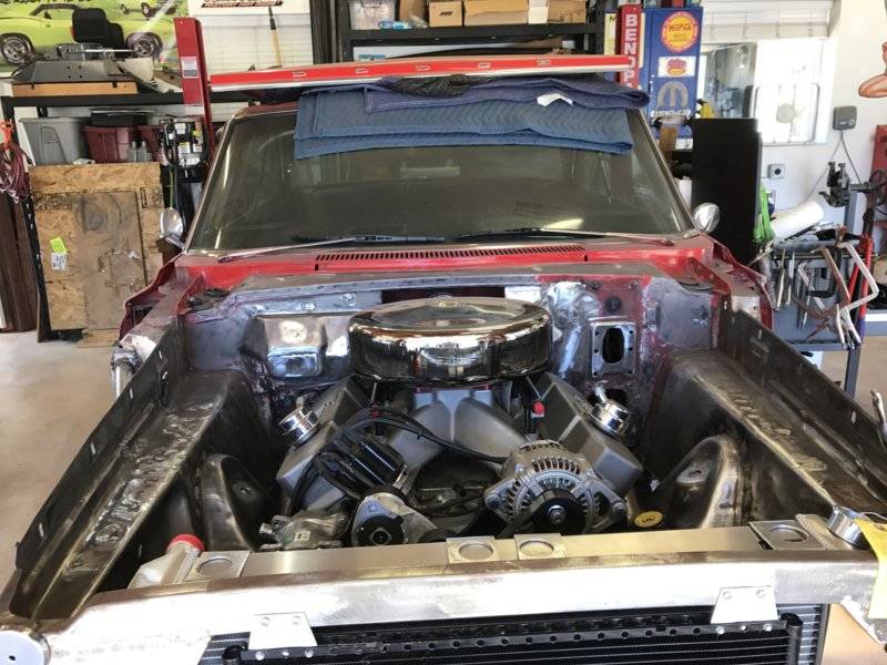

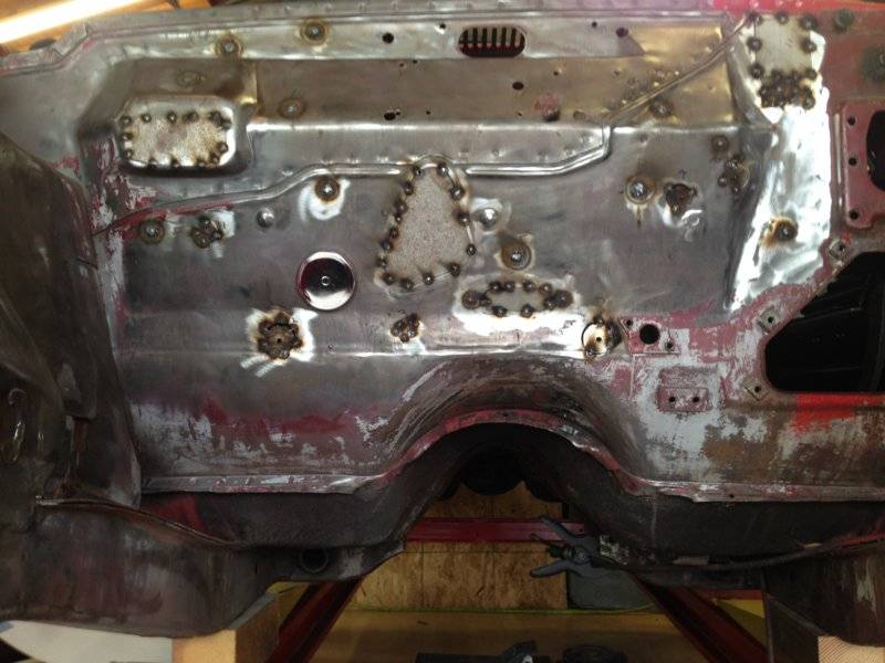

I'm going to use the 24/7 setup from Ron Francis on mine. I capped off most of the holes on the firewall and will be bringing the wiring in between the inner and outer fenders and the same for the HVAC stuff. Have not done all the work yet, car is back burnered until garage is built [I moved], but some of the work is in progress. I saw these nifty firewall pass through units at SEMA and will be using at least one for the wiring.

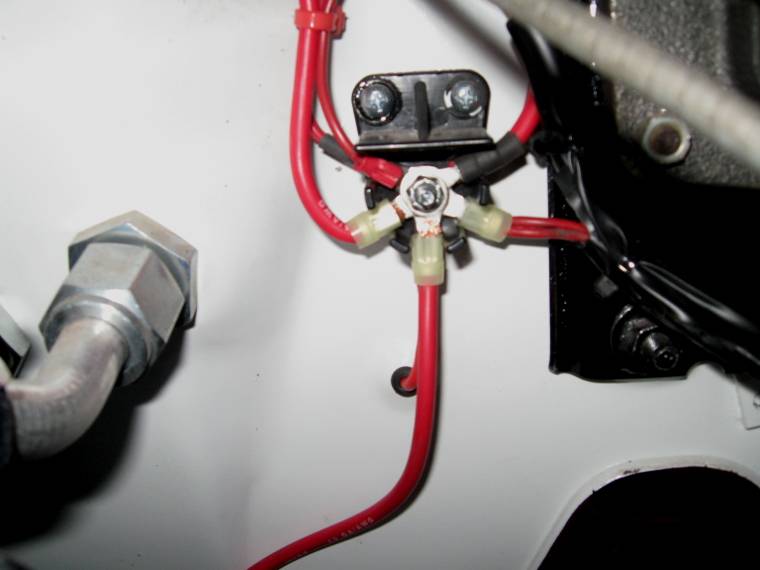

Positive Junction Block mounted under dash, made a small bracket.
1) Connected the ‘Start’ wire (Brown).
2) Connected the ‘Run’ wire (Blue Tracer).
3) New wire to positive on coil.
4) New wire to a voltmeter.

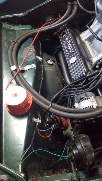

5) Original harness runs on driver side inner fender. Removed wiring from engine on passenger side and routed on passenger inner fender. Factory holes already there, used factory harness clips. No wires on engine.

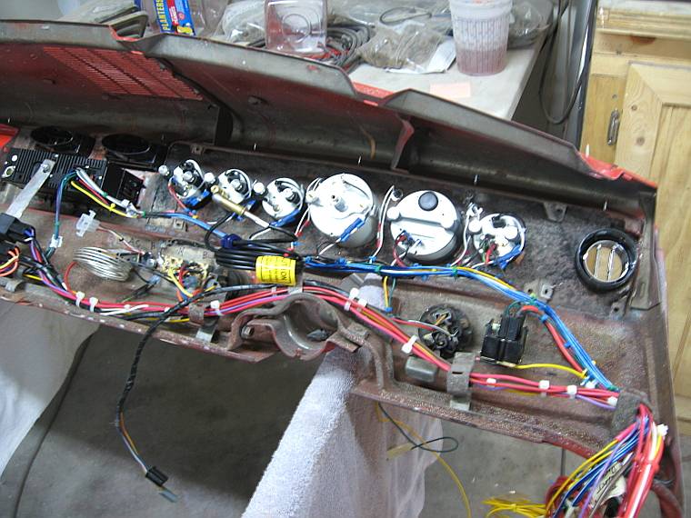

7) New instrument circuit boards and lights. Made a small harness to ground every light, from the back of the instrument cluster to the dash.

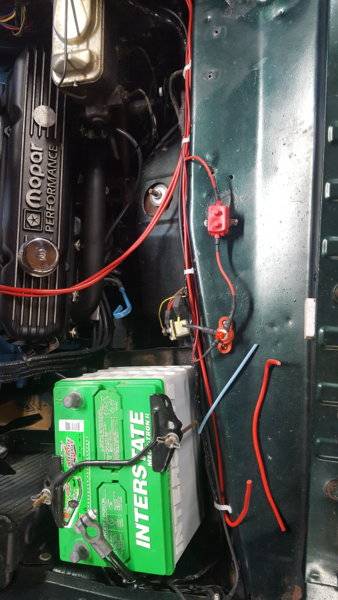

8) Negative hub mounted on firewall next to battery.

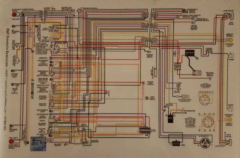

Pic of my original wiring diagram, which is a large laminated color copy, I think I got it on ebay, and it was a great tool.

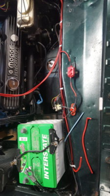

Other pics are during the re-wire, not the final product, but it might help.
