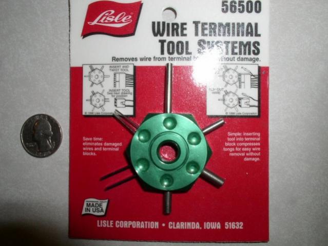

looking for the tool that allows you to remove the wires from the termination blocks and switches on our mopars thx
On the cheap a very small flat blade screw driver works. Look for the locking tabs and press them in and pull at the same time.
