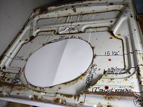

After searching I still cant find under hood pics. looking to see the size and shape of the hole to see if my air cleaner will work.
This is designed to work with that hood.
View attachment 678007 After searching I still cant find under hood pics. looking to see the size and shape of the hole to see if my air cleaner will work.
You said "see if my air cleaner will work". Of course it will work. You already have the size and shape --- it's the air cleaner. Note: Chrysler engines are offset to the passenger side by about 1 1/2 inch. To find the center of your hood cut, just put a longer air cleaner stud on your carburetor and slam the hood down. That will mark the underside of the hood just perfectly.
