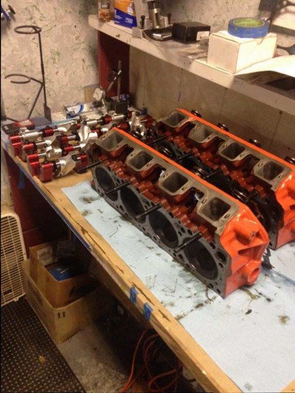

Motor is out, started breaking it down ..

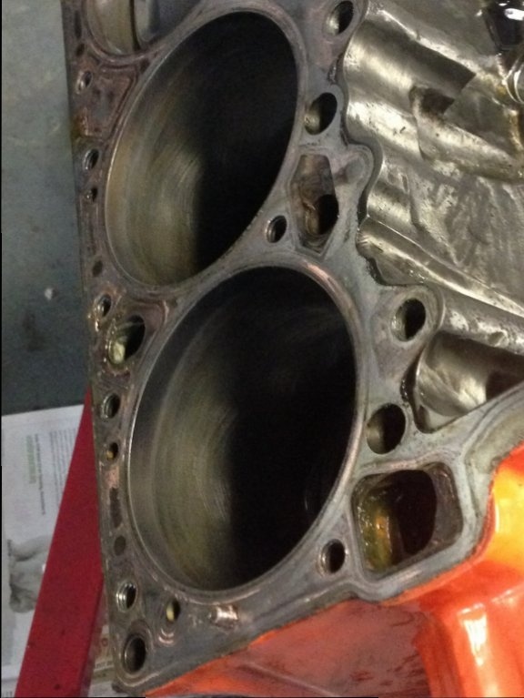

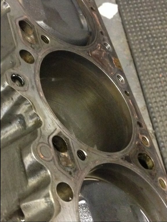

Air cleaners work... These cylinder walls have 10 years of street/strip on them. I would have no issues doing a touch hone, new rings, and tossing it back together.

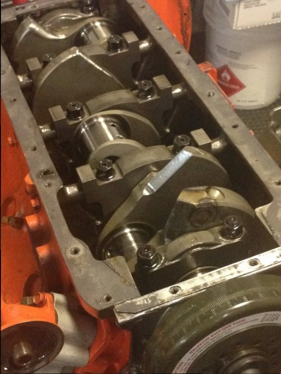

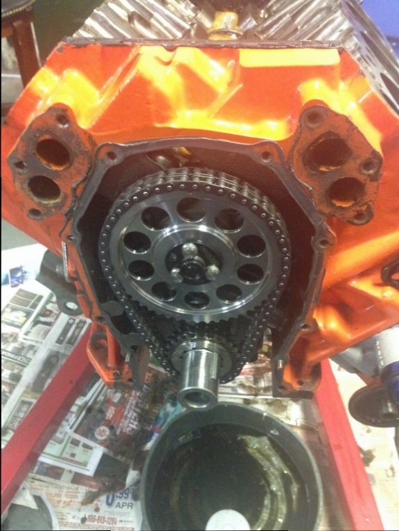

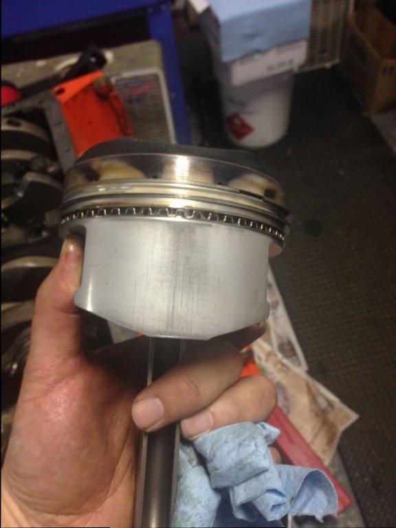

Broke it down the rest of the way today.

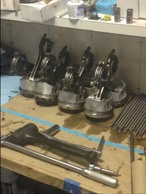

Pistons & rod bearing look really good, rings are shot. Timing chain is junk.

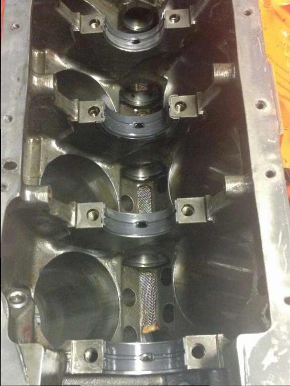

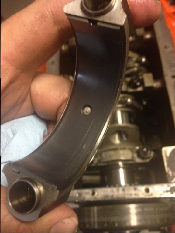

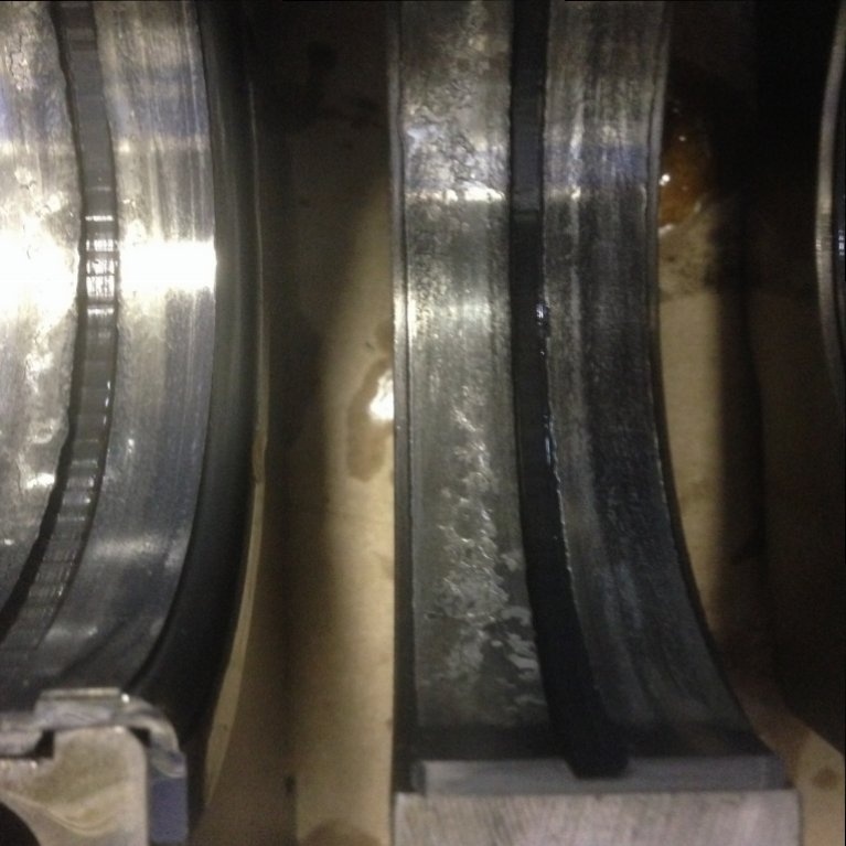

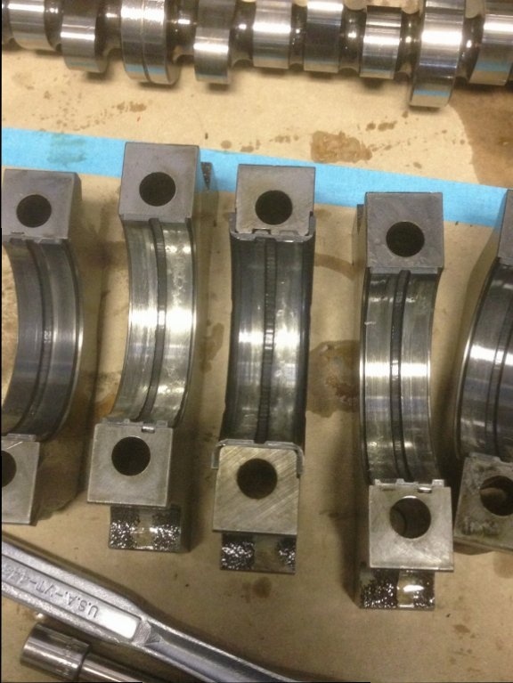

Then I got to the main bearings. Lower middle are completely wasted, uppers not nearly as bad. Crank is still ok. that's why it pays to tear em down while their still running good. They were ok when I last had the pan off. That was probably around 2010. I knew it was time!!
Thats exactly why i was going to tear mine down this winter.
My bearings looked great!
Except for my little mishap .
When i tore down my wedge same story. Rods looked like new #2, #4 mains were beat. I went up to .004" on the mains last year. We'll see.
Doug

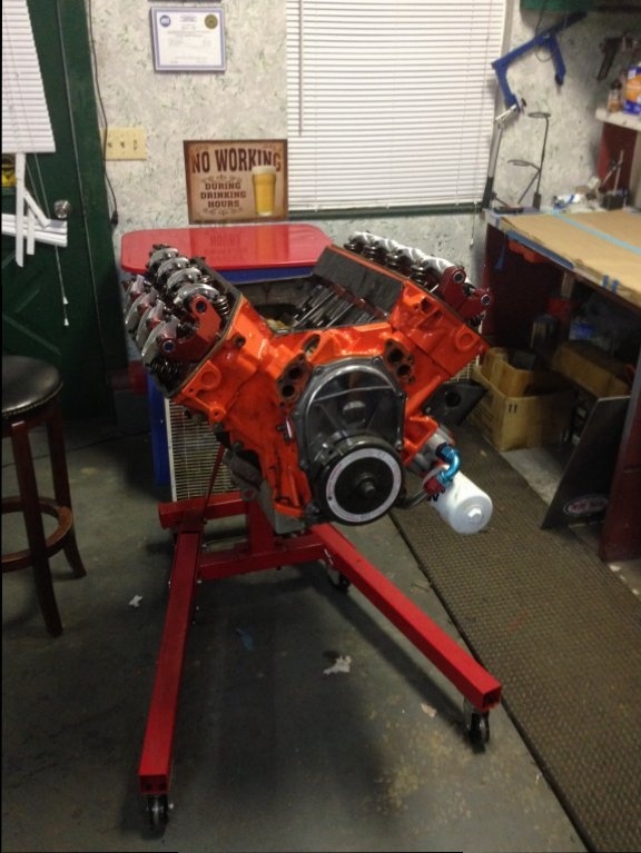

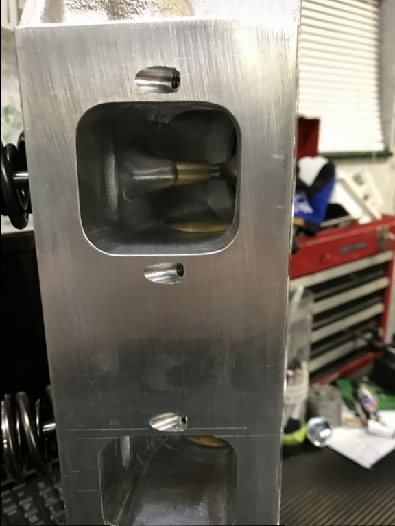

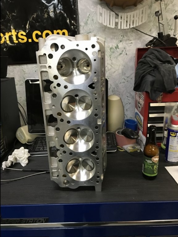

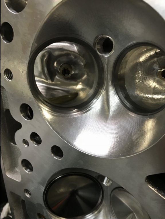

So what's the plan? You've lost a bit of weight off the nose. Def stepped up in the head department. Cubic inches are there. Sheet metal cross ram? Big single?
Not sure yet, still gathering parts. A buddy of mine has a few sheet metal cross rams that are obsolete for super stock. Said I could try one out. It's still gonna be a street car so I gotta be careful not to go overboard although it's pretty easy.
Hmmm period correct individual runner tunnel ram and dominators gets my vote lol
