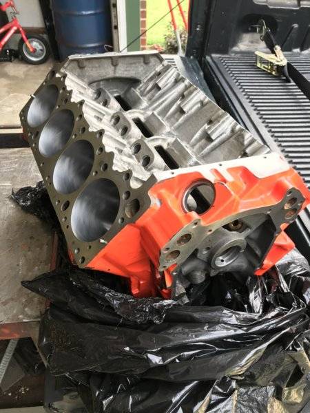

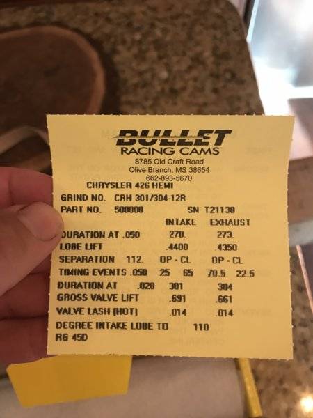

Cam showed up today from being regroud at bullet! Should be a nice street cam.
Nice build!
I'm in the process of building a 11.5:1 to 12:1 572 as we speak.
So I look forward to seeing your progress, keep us posted.

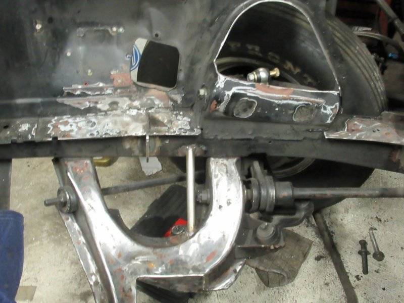

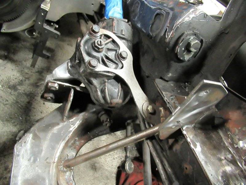

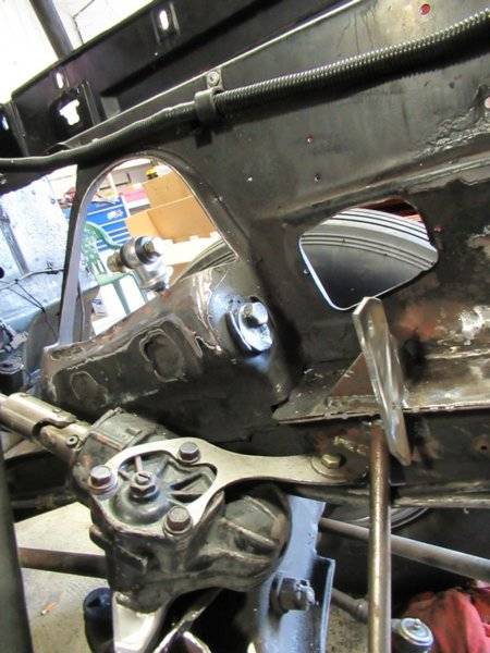

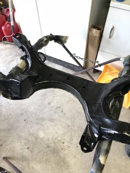

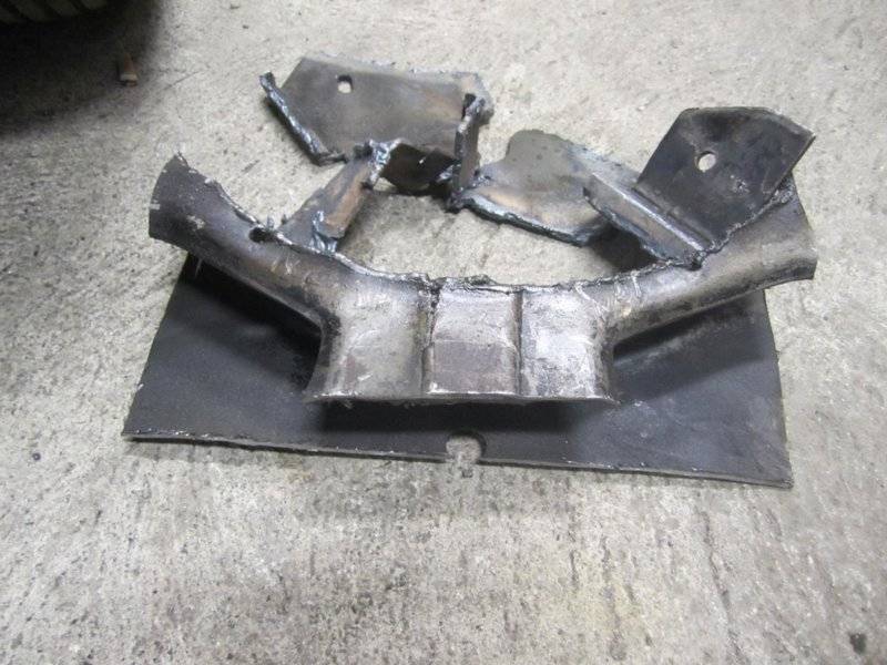

I'd cut that K frame so the oil pan can come off. You will thank me later.
Doug
I notched mine similar to yours.Can get to the front oil pan bolts with a shallow socket & extension.

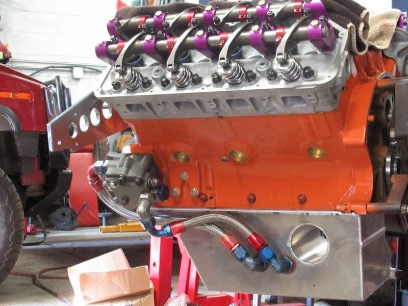

Aluminum heads & stands will shave of almost 9o lbs!

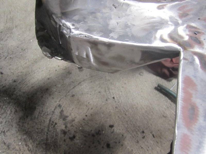

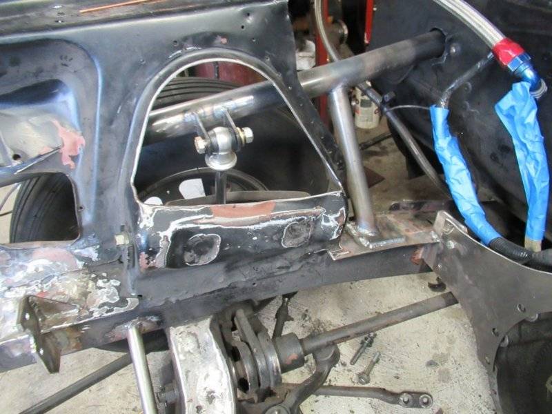

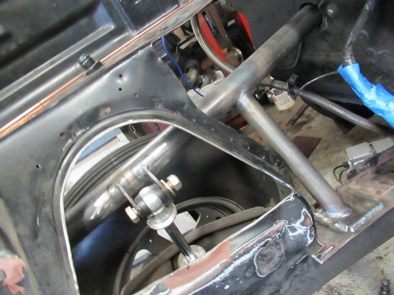

I trimmed the lip off the rear and welded it up. That’s as far as I’m going. Roads are brutal around here, I wanna keep some integrity as I do and will continue to put miles on this car.
Supposedly they help, figured can’t hurt as easy as they are to add. 9’s? Shouldn’t be an issue. I don’t have the safety equip though so I may be slowing it down as I don’t plan on adding more bars at this point.

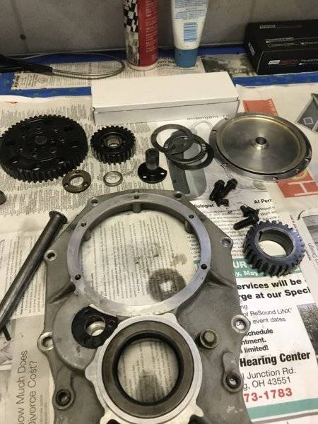

My dad come up with a used gear drive a few years back. I dug that out to see what I need to make it work
Nice, you can MPH them at the top end that way. I had a turbo bike that was about a tenth slower 60 ft than every one else, but had a great top end charge. If they were only 1-2 bike lengths on me at the 1/8 they were done.
