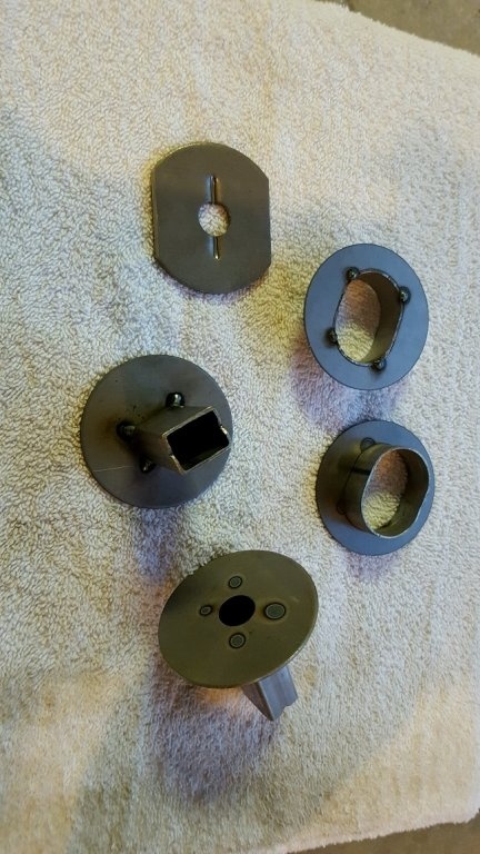

We are getting close to having these available for those cars needing these pieces. The metal fab work for the K-Frame isolators is complete and we are now doing the transmission / torsion bar metal mounts. The stage we are at is making the correct rubber bushing that is used in conjunction with the metal pieces. I would like to say that they will be available by April. These pieces will be exactly like the originals including the mounting bolts, the only thing that will be missing will be the part number that is molded into the originals.
