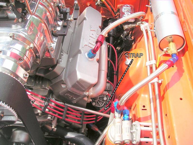

Ran stock mounts ,engine, tranny with torque strap , I also drilled through the motor mounts at put a 5/16" flat head bolt/ nylock through the mount to keep the rubber from separating from the mount .that was before the torque strap.street car I made my own strap but mancini sells a real nice one. Item #: SCHTQBE $82.00

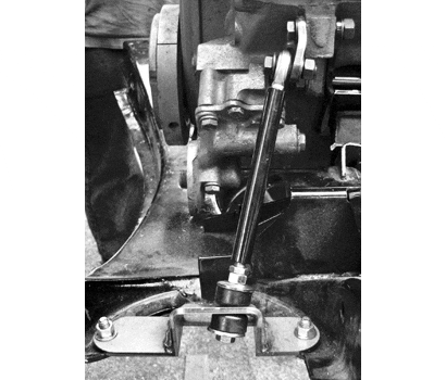

I run a QA1 cross member so I need to fab my own torque strap but maybe the 5/16 flat heads through the stock mount isn’t a bad idea either.

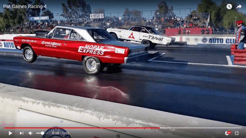

On my 10.15 second Coronet I run Moroso Steel Motor Mounts and a stock rubber trans mount. No problems.
I also have a transbrake and launch at 3800rpm with a 1.40 60'.
I have the QA1 cradle as well and I'd be very interested to see what you come up with!
I got a hunk of 1/2" stainless steel round stock, two 3/8" heim joints, drilled / tapped, picked up a 4 bolt clevis mount and drilled and tapped the the ledge of the frame rail 1/4-20" to attach it. worked great.good luck

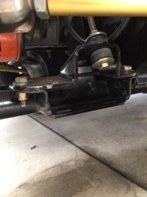

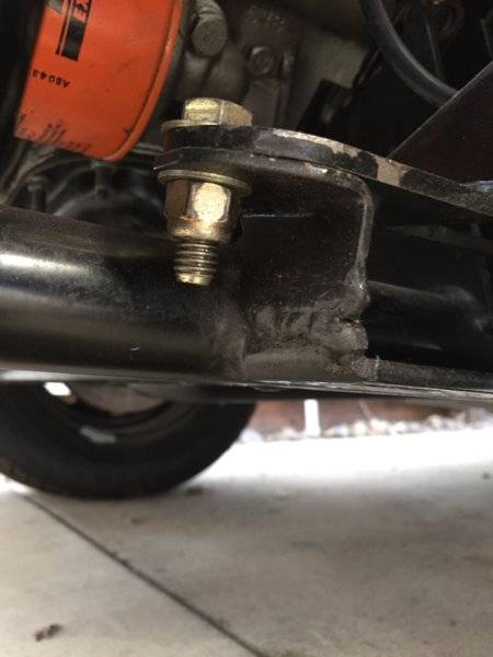

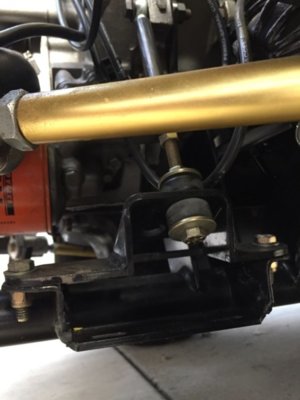

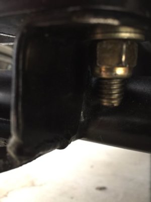

QA1 k-frame with Schumacher torque strap. I used some angle iron and welded to the k-frame, drilled the holes and bingo, all done.
7C960CB6-8213-4537-94BD-B713E4D0071B.jpeg F24FB669-68DE-446C-8CE8-374DDADF8C25.jpeg 4FD4B381-04AF-4849-9385-74B8A68A3FE1.jpeg 2D23CD9E-079B-477F-B1B5-C489D1AB2123.jpeg
