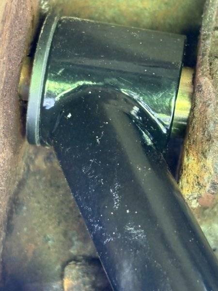

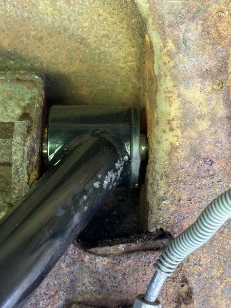

I installed the drivers side tubular upper control arm and this is how it went. The bushing fits nice and tight, but look at that gap between the arm and where it sits. I bought them from parts geek and it says it’s for a 67 Charger.
This is going downhill quick.
Can you pull the control arm back out so we can see what's actually going on

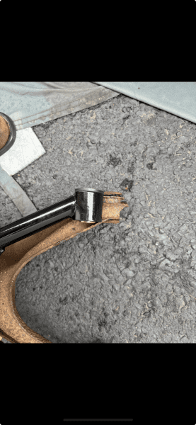

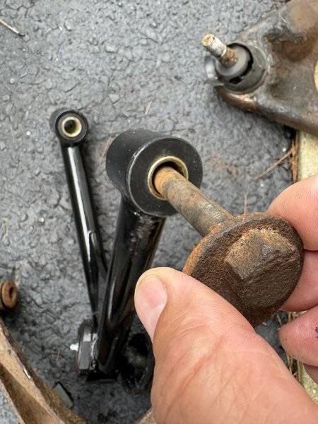

My new bushings should be here on Tuesday. I will post some pictures then. But the arms themselves are the same size, but on the old arms the bushing sticks out a bit. On the ones I used, not so much. Looks to me like they just use the wrong sized bushings. You know how you have a big washer on the outside of the bushing; these don't have them. I have to say though, the old bushing, it fell apart in my hand when I pulled it out. The car has not been on the road since 1984, and it shows with some stuff I'm finding.

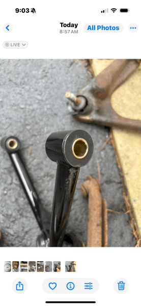

This is what Im using. They have the washers on each end. Can these bushings be changed easily, or should I just take them to a shop?
My concern would be the new bushings are nothing like what that totally different aftermarket control arms use. Hope I'm wrong. Yes, someone that knows what to do should be involved
I did see a review and the guy says he had the same problem with them (wish I had seen this review before I bought them). He wrote he had a set of bushings and used those. If you look at the picture of the bushings, you will see there are washers on each end of the bushing, they are not there on the ones on the control arms I put in.
My recollection is that those newer bushings resemble the original ones which don't just have a washer.
It's a tube that has a washer like flange on the end and that metal tube presses into the rubber portion from the other side and when it's tightened the frame is crushed up to it so that it can't crush anymore.
The OEM bushings also have a sleeve pressed on the inside of the bushing so it can't change position.
Those bushings you have now would likely allow the arm to move and change you front end alignment.
I would suggest you tighten the eccentric adjusting bolt and nut AFTER you set the car down and get the adjustment close before sending off to an alignment shop so that the bushing isn't being twisted to start.
However, if the new bushings are poly the poly bushing might rotate once it is tightened anyways and it means nothing.
That is correct. That tube your talking about has the bolts going thru it and its snug inside there. its not moving. I was worried about the bushing moving side to side without having those washers on each side like the original.
Even the originals can move without the sleeve pressed over the bushing from the other side.
You will need a set of four collar sleeves to press onto the new bushings as well if you really want to cover yourself.
You could place spacers/thick washers on each side to prevent them from wondering side to side if they were the right thickness. Like hardened washers. If not back to the other bushings with sleeves.
That being said there's a lot of Mopars out there without sleeves pressed behind the bushings. I put mine back on because I figure they are there for reason.
New bushing sleeves are not easy to find. Some people during bushing replacement stopped putting them back on because they break or rust off. I was lucky enough to make them on a lathe out of a large nut bored out in the center.
But you are right about the spacing. The arm can move if they are able to overcome the press fit.
Again the original bushing like those in the picture can possibly move if you don't have a collar on the opposing side to lock them into place.
Good luck with the decision
