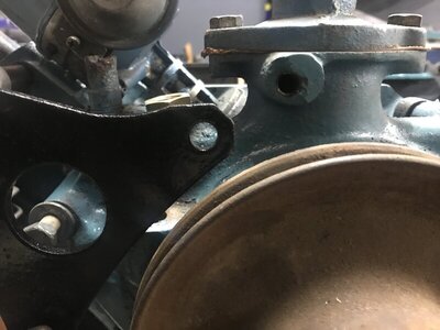

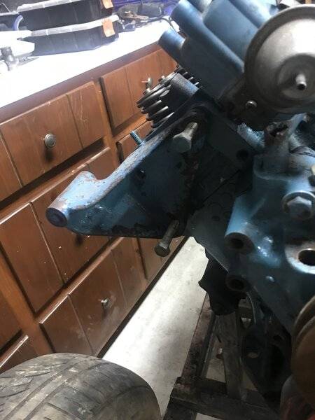

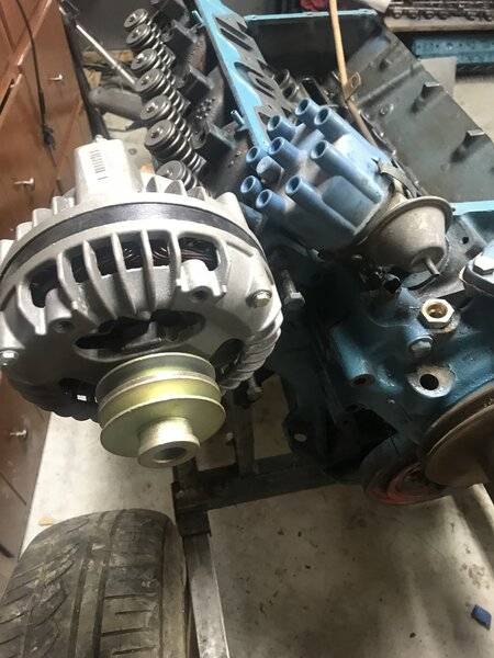

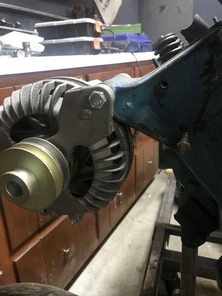

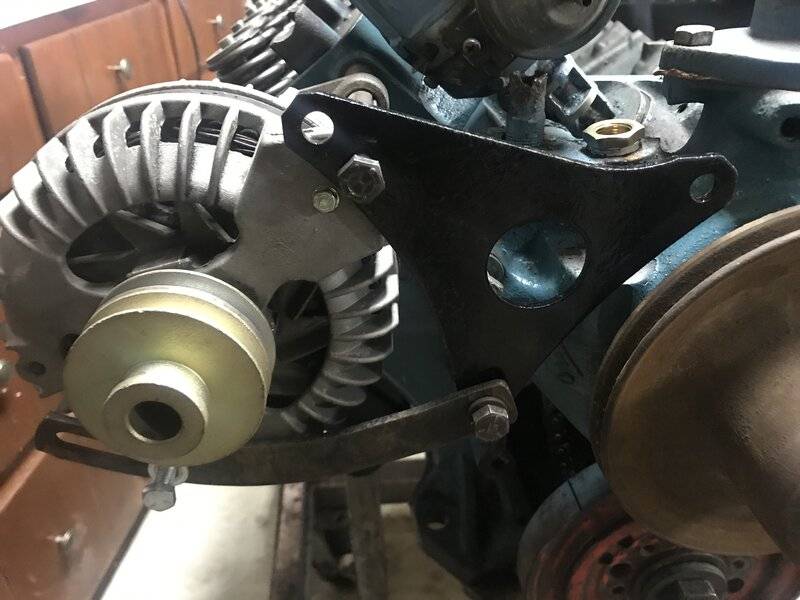

I had this bracket and it fits in the passenger side head. I believe it’s for a alternator relocation. I tried using the bracket I bought from a guy here but the main y looking bracket lines up with the head hole and the bottom water pump hole but it’s too short for the bolt that goes below the tsat housing. The bracket I’m posting is a wtf bracket.

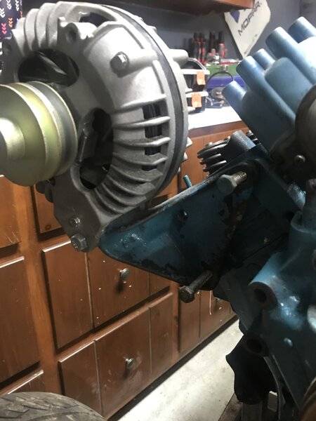

And this is the bracket I got from a guy here. It’s too short to make it to the tstat housing bolt hole.

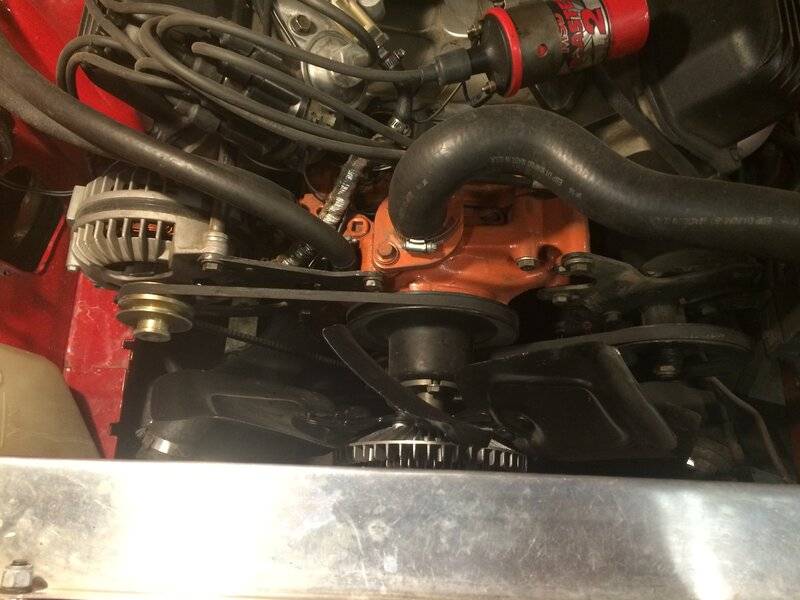

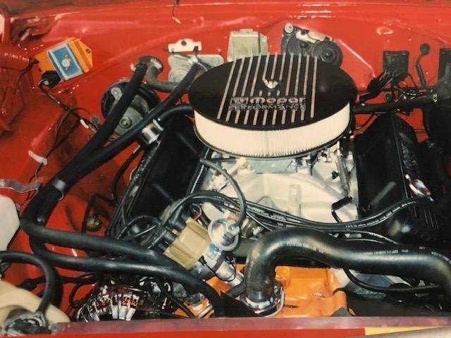

The triangle bracket is mounted wrong.
I'd have to pull a radiator to get a proper angle for a picture. That is a NON A/C alternator bracket. The hole in the middle is for access to the water temp sending unit.
Like a lot of things with cars, I can usually figure it out when it is in front of me but describing it from memory can be hard to do.

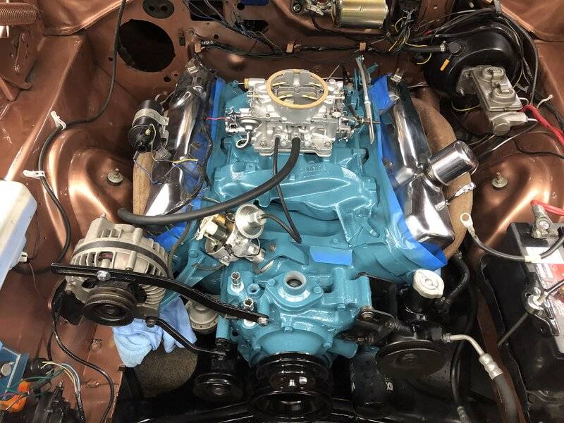

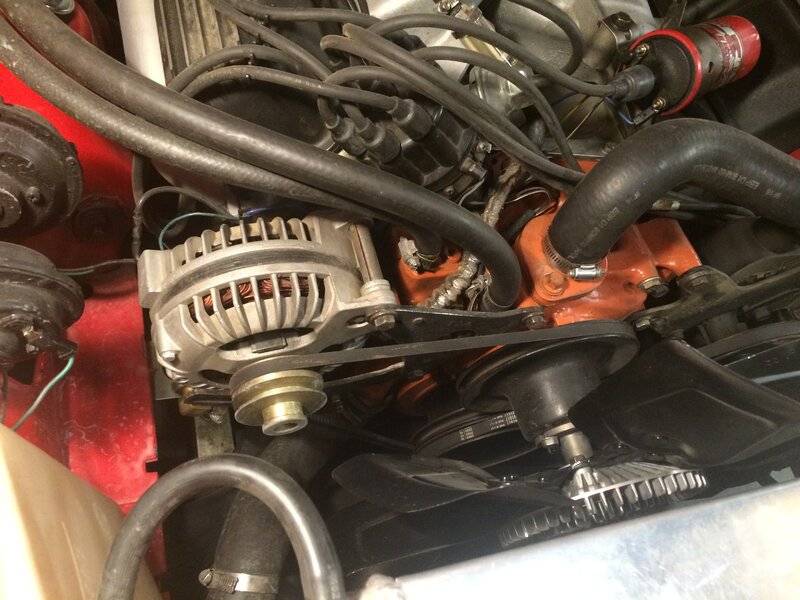

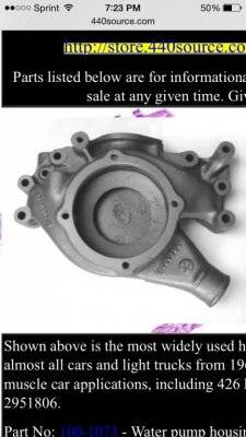

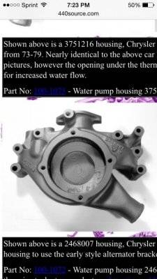

Here’s pics of the two different styles of water pump housings notice the boss on the housing for the alt bracket
Kern dog’s pic above has the correct bracket and housing match. You have a 73 up pump housing.
The water pump housing is part number 2468007. Says 64 to 66.. So I think the ones I got from the guy here are just wrong.... 67-up
That’s it! I had the year wrong On the housing but yes you need the older bracket
Reading the description of that one it says HEMI cars But it shows the 2468007 pump housing.. I assume its the same as for B/RB ?
