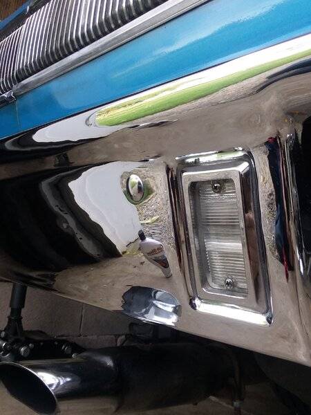

    I agree with this, and I use them in tandem with each other. After years of neglect and sitting around untended, I used chrome polish and steel wool to clean these bumpers. This is the first attempt. Another attempt is forthcoming this winter.

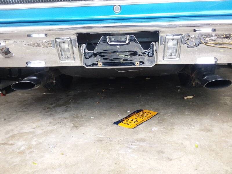

        Thanks to all the advice you guys gave me about my bumpers. I rummaged around my cleaning stuff and found this metal polish I didn't know I had. Tried it and bumpers now look new again. Thanks again guys.

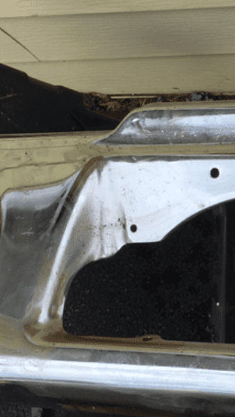

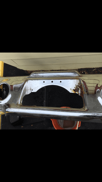

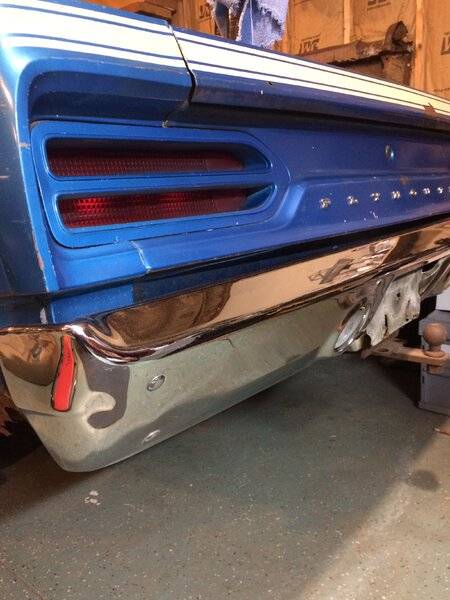

          I too say steel wool, use what ever grit needed and go finer. I use soapy water as a lubricant. Then a polish. This is a ‘70 Roadrunner bumper.

            My bumpers now. Thanks for all the advice guys.

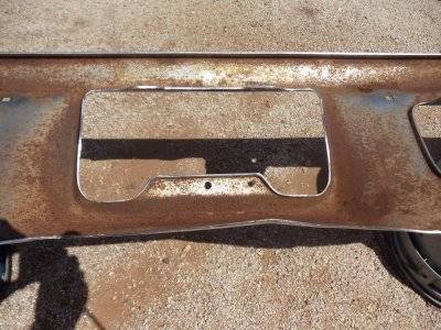

                  I renew the back side of the bumper first, which is a lot more work.
