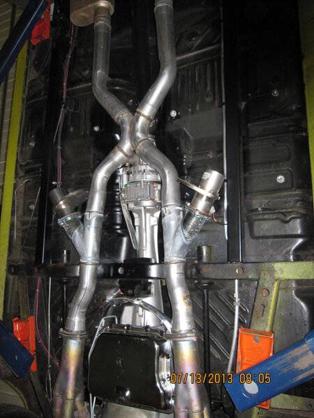

You will have to move it further towards the back.....

Why not lengthen the extension pipes, in front of the X-section, and remove what is needed behind it ? You may be able to use the mufflers you already have.
that s what i m thinking of doing not sure if i can cut from the back to add to the front of the X since the back wont be wide enought to connect to the muffler after that "surgery"

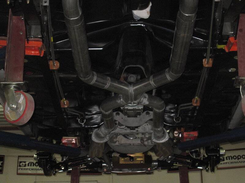

Muffler shop and have H-pipe made that clears the Gearvendor better than the TTI. It's about $10 US in pipe n very little labor.

just got off the phone with a gear vendor guy he confirmed that a preexisting X pipe will get in the way so i would have to get a metal shop to build me either a compatible X pipe
Just get a local exhaust shop to fabricate something. When your not in the US (or even if you are) you need to think outside the box a little. I found a local guy here with a CNC machine who has made spacers for my disc brakes, an alternator bracket, some cones for my MTB rear axle all for cheap.
My car is currently having a new 2.5" exhaust fabricated by a local guy for cheaper than I could buy and ship from the US. I dropped the car off yesterday and it will be ready tomorrow.
There are skilled local tradesmen all around the world. You just have to reach out and find them.

You will most likely have to do some grinding to allow the trans cross member to drop down about 1/4", you may also have to dent the trans tunnel to clear the two ears on the top of the gear venders unit.
