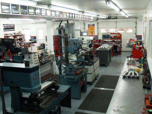

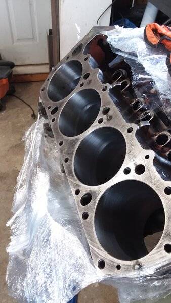

So,....I made a judgement call and transferred my engine block and heads to another shop. The one I started out with was like a dark cave, very grungy and dirty, crap sitting around everywhere and nothing clean or maintained. Bad vibes all around.

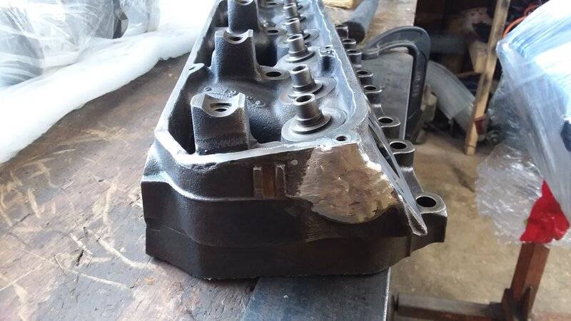

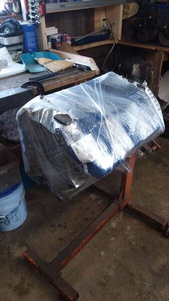

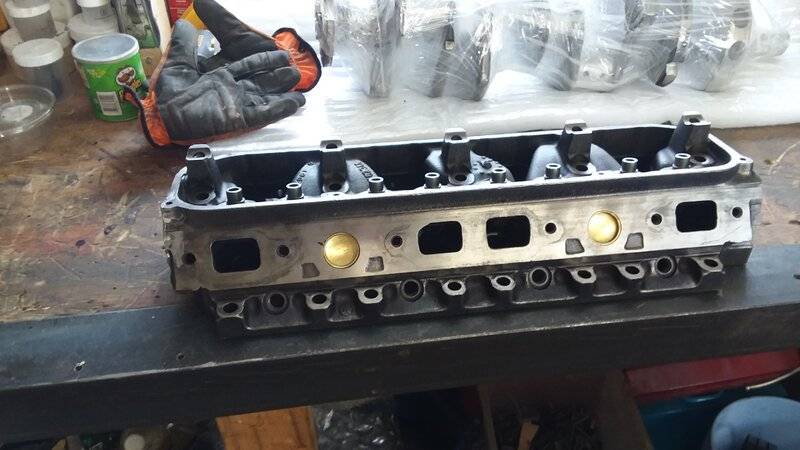

So, I picked up my **** yesterday and drove it all up the hwy 20 miles and dropped it off with RPM Racing Engines in Georgia, VT. Spotless shop. Well lit. Smiles everywhere. Helpful and polite. Better prices. Offered to try to repair the bunged up freeze plug hole in the end of one of the heads. Nice place and well run. When they give me back my parts they will be spotless and wrapped in plastic with a film of WD-40 on them and would be absolutely ready for assembly. Just run a clean rag with new oil on it through the bores and put it together.
So, he's going to do the following:
Wash the block and heads
check bores to see if they need to go to .40
cleanup pass on block surfaces and head surfaces.
install cam, rod & main bearing
polish crank
check valve guides
rod out oil passages
final wash

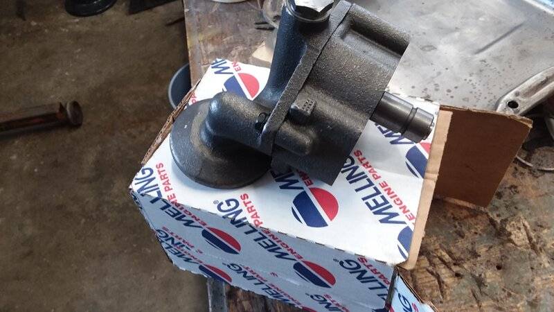

replace oil pump
new pistons if needed
positive Teflon valve seals
Moly rings
We will go from there as I get more money and he's fine with my engine sitting there till I can. He had several engines that were finished and wrapped in plastic. Looking good. They build engines for racing people all, over New England. $775 plus parts. Cant beat that.
Later on I'll have them do a valve job and replace guides of needed, install crank and cam, maybe pistons and rings, maybe heads and valve train. I'll do the rest.
I'm more comfortable with this business.
