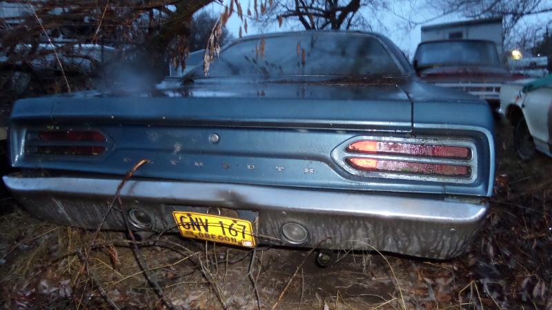

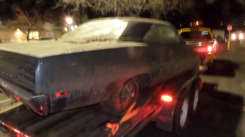

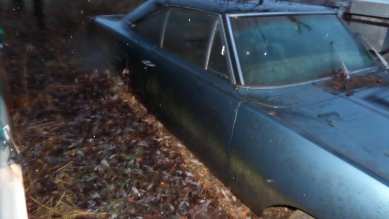

Hi everyone.
Last week I just picked up a 1970 Road Runner that has been sitting for the last 10 years in a back yard field area. It appears fairly original other than it was repainted sometime in the past.

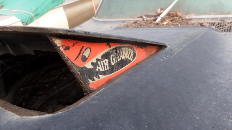

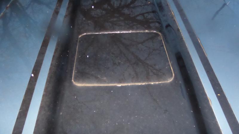

The car is originally yellow. 383 with a 833 4 speed and Dana 60 rear. hood package and air grabber from the numbers on the fender tag .Interior looks stock.
If the car is a number matching car I will keep it that way.

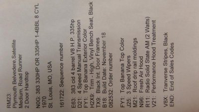

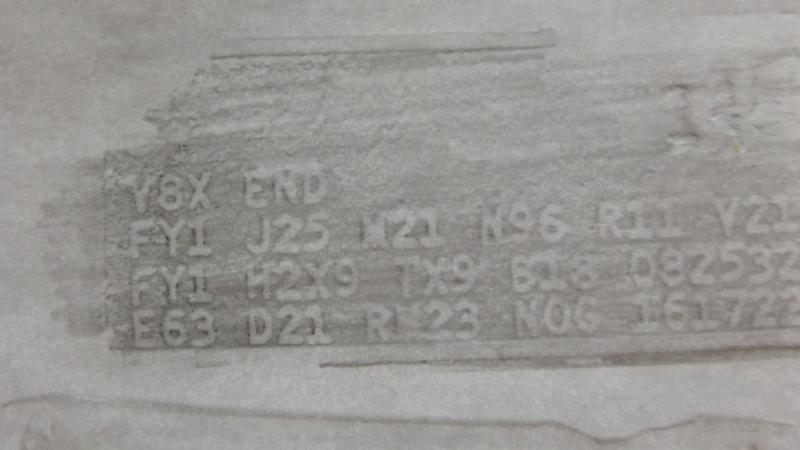

Please post the complete fender tag, I doubt the car you decoded above came with a Dana 60.
SAM_4426.jpgSAM_4428.jpgI entered the numbers of the fender tag online and came up with the info above.
I have read where the tag is like a lot of old cars and doesn't always have all the options listed on the tags. The engine and trans date code are prior to the build date. It does have (on the car now)a Dana 60 differential and disk brakes up front. I am still looking for the build sheet in the car.
I'm here to listen and learn. I know someone had many years to replace parts on this one. I want to know what you know.
Did no 383 RR ever come with Dana 60?

Only under warranty as replacement for 3.91 with 4 spd if it failed.

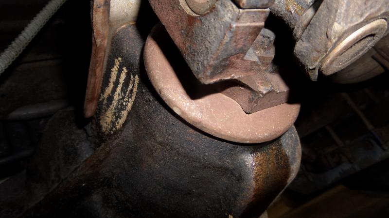

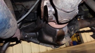

Thanks for that info. I assume it's a Dana 60. The cast # on the rear of the diff. is C34155 and below that is a 60. On the passenger axle tube is 877B and 602957 1. Driver side has 6 leaf springs and passenger has 7

Nice find! Is your rear axle pumpkin smooth on the back or does it have a rectangular bar going up and down the back?
Hey Ghostrider,

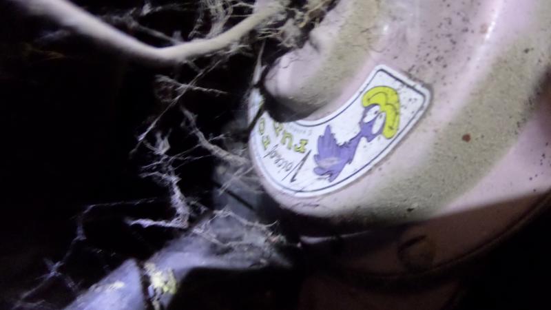

more pictures

Yes, that's a Dana. Nice car - great find!
Looks like a jewel in the rough!! Give her a bath and lets see what you've got.
Thanks DJD, I love those pics and hope you find the build sheet, hopefully it helps determine if the 60 was factory. I have a RR with a 60 but the fender tag shows the STP option.
If that Dana is original to the 383 car, it would be a rarity. Not necessarily more valuable, just far more rare.
Thanks guys for your support.
So we now know it is a Dana 60 but rare if born with. I read where the Hemi and 440 could have this as an option.

Looks like you found a great car! I agree with others that it would be highly unlikely that a car with a 383 would have a Dana. Like others have suggested, see if you can find the build sheet. I would bet it originally came with a 3.23 open rear 8.75". I say this due to the fact that there are no performance axle codes on your trim tag, so the standard axle was probably supplied.
