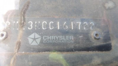

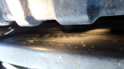

I am more concerned with the engine stamp on the passenger side just rear of the motor mount. that is #9G294248. Is that a VIN?
Those are last #'s of a VIN. From a '69 car from St. Louis plant, unfortunately not matching #'s. Looks like standard drum brakes & axle, maybe someone robbed a track pack car? Regardless a really neat car, looks rust free, great find.
Would be interesting to see what trans it has, maybe a hemi 4-speed given the Dana? You could make some $ if so. Check the trans pad, should have last digits of VIN same as engine.

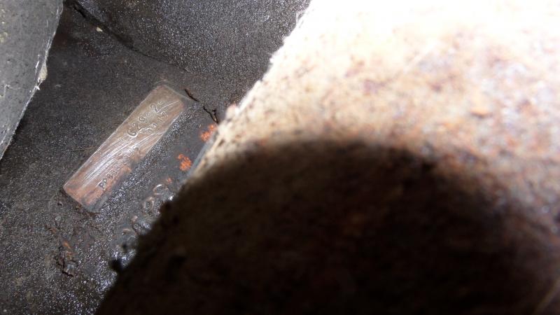

The trans is a 833 4 speed.
I read pp8332876 as new process 833 also built in 69.

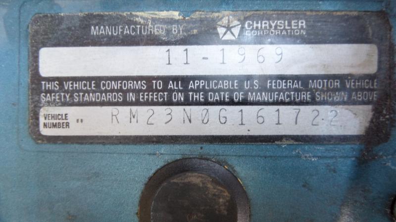

I know were past believing ( still hoping though) they are borne with.--BUT-- didn't Production of the 70 model end in Dec. 1969? Mine was made in Nov of 69 so shouldn't part numbers be dated 1969?? Trans, differential , engine etc.

The 9 in the engine VIN portion means the model year, not the year it was made. The trans code 2876 is the date it was made which should be 6-12-69 or the tail end of the 1969 model year. The portion I can read on the trans S/N appears to be the same as the engine S/N. Are you sure the engine is a 383 & not a 440? If a 440 then should have the hemi 4-speed. You can't tell whether it's a hemi 4-speed by external markings but you can remove the inspection cover & eyeball the bearing retainer for positive ID. Of course if it came with the same S/N as a 383 then no way will it be. Anyway, it's a virtual certainty that it's not the original drivetrain but it has nice options & color so who cares?

That guy's memory is probably semi accurate. No Chrysler build info after 1967, something about a fire destroying the records. You have the data plate which should tell you the important stuff. Build sheet is a crap shoot, lots didn't have them. You can check the VIN sequence # on the rad support & left trunk lip under weather strip to get a good feeling the car isn't pieced together.

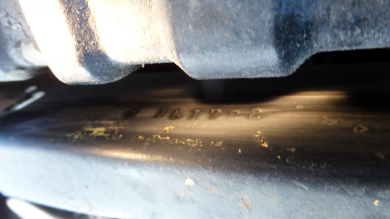

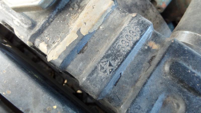

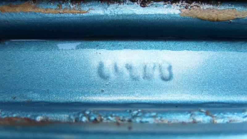

Rad. support matched vin. Cant read the trunk number.

If the 5th picture is of the number on the trunk rail, you are looking in the wrong area. You need to go back and look under the weather stripping, not in the drain trough.

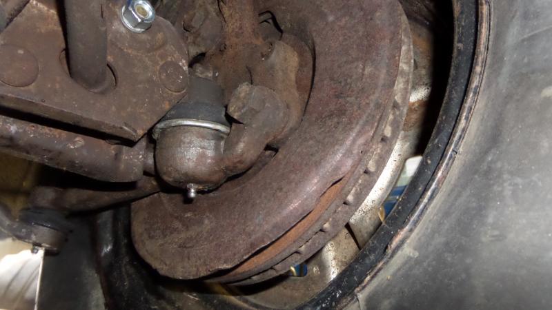

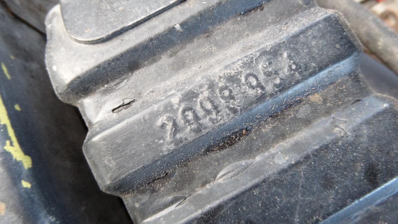

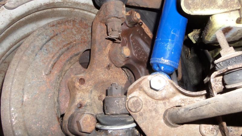

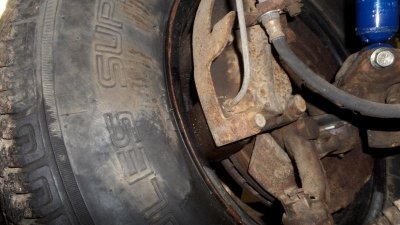

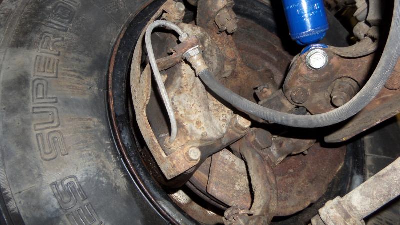

Stuff shown looks good. You have the high $ max cooling radiator. Front discs look like the Bendix 4-piston variety from a pre-70 car. 70 B's used the single piston type mounted on the forward part of the wheel. Again appears like parts were transferred from other car(s) but they used some really good stuff. What color will it be? The blue looks good but it would be a knockout with the original bright yellow & black.

No, production ends in July of any given model year, so the end of the '69 production would've been sometime in mid-July 1969. The 1970 production would've started roughly two weeks later, around the first of August 1969, and run through the second week of July 1970. So, your scheduled build date, the VIN and the other info clearly indicate your car is a 1970.

So -HERE WE GO- I installed new shocks on the front and repaired the front stabilizer bracket. Rebuilt the carb. Ordered a D.U.I Tri Power distributer, platinum plugs , Live wires and black carpet kit from Summit. The new fuel pump and heater core are already here. But it's 10 degrees and 4 inches of snow outside.

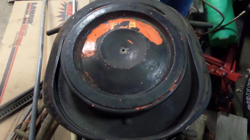

SAM_4277.jpgWhat would be the correct graphics to be on the air cleaner when on a 1970 838 roadrunner with air grabber hood including Performance hood treatment?

Someone mentioned that their Air Grabber switch was red or orange. I found that one in the glove box.
