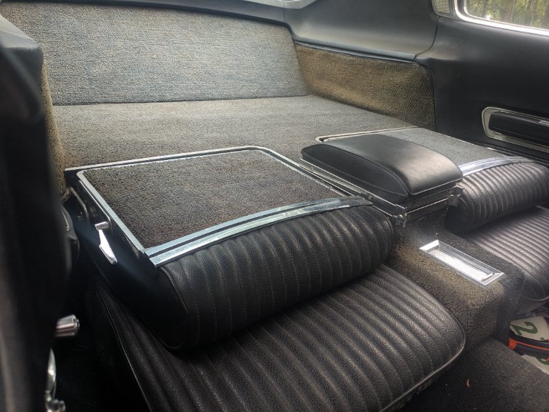

It's not the typical rear seat in these. They fold down but probably not like you're thinking. And the back panel folds down from the trunk side. It's definitely a puzzle.

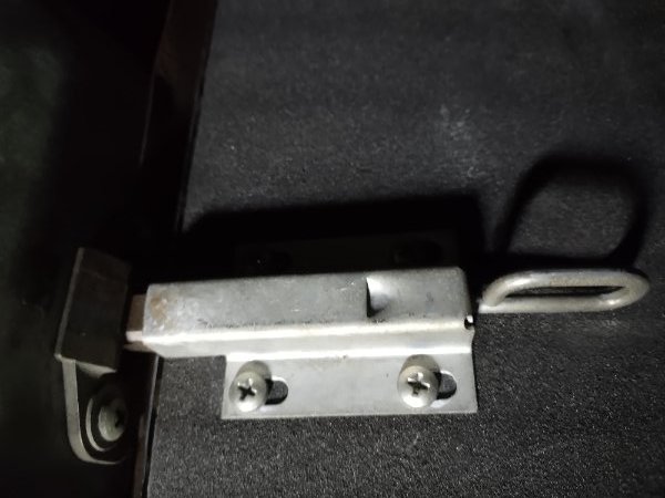

Find one of the latches, they are like a door latch.
Keep working the latch downward until it releases.
Slide something in there to stop it from engaging. Or you might be able to push the panel back.
Repeat on the other side.
Then you can get to the back of trunk latch and open it with a screwdriver.

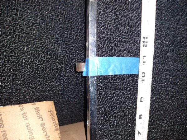

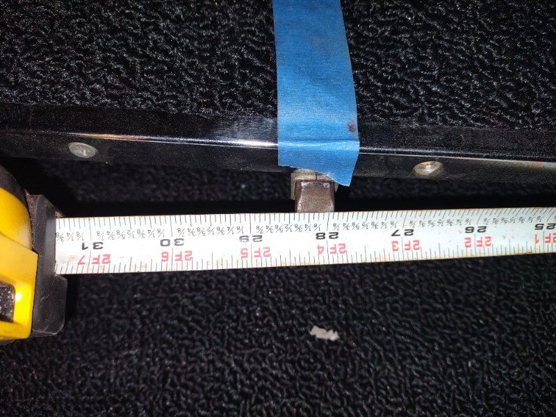

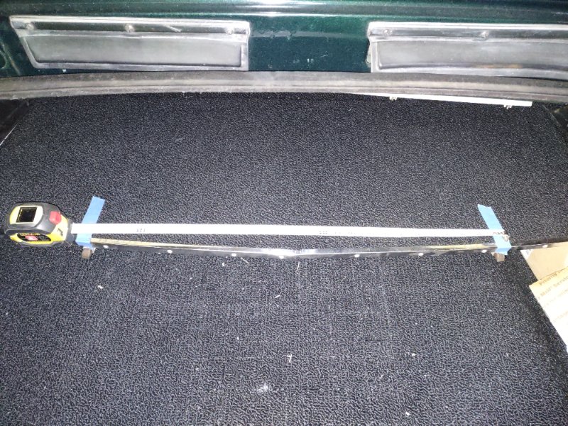

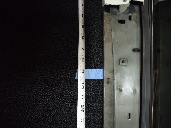

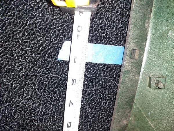

I just went out and looked at mine.
I'm not as optimistic as I was.
At least on mine from the inside the latch is up behind the rear window sheet metal.
I laid out some painters tape and took pictures of where they are located.
Let me know if you need anything else. I'm hoping to get it in storage on Saturday.

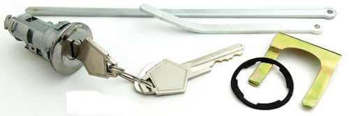

Could be that the rod between the lock and latch fell off so when you turn it, it won't pop the latch.

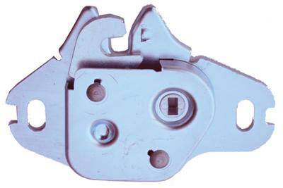

If you drill a hole through the lock, you can stick a long screwdriver through the hole, into the little slot of the latch (verticle slot in this pic) and turn it. Pops it right open.
Hope it doesn't come to that but that looks like a possibility. Thanks.

Fold down the back seats. Then find the latches.
Sam69 posting shows the assembly for non Charger 66-7 b bodies. Won’t work with 66-7 Chargers. They are unique.
Study the latches carefully.
