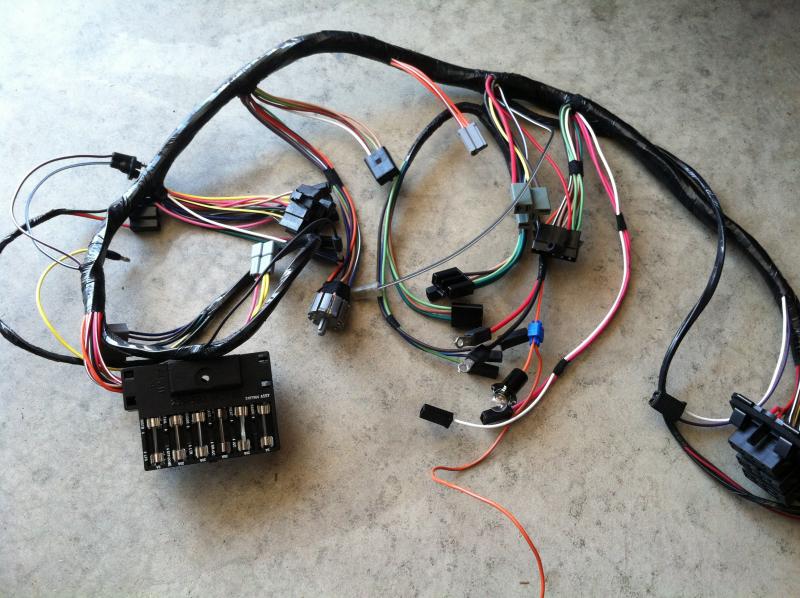

Got both harnesses. Just finished the install. Plug and play. Great quality.

Drove it to a couple cruises today, over a hundred miles. Everything works. Except the trunk light. I can do without it for now.

Looking at the photo I see an inline crimp (blue) - I have had mixed results with those in the past. They can 'rattle' open over time. Having said that, Year One do sell nice looms - I have used their Engine and Forward light harness on my cars. I chose to replace the rear light harness with my own work - you can't tell the difference. It's all about colours or cable, correct factory style tape, and the use of concealed modern heat-shrink tubing.

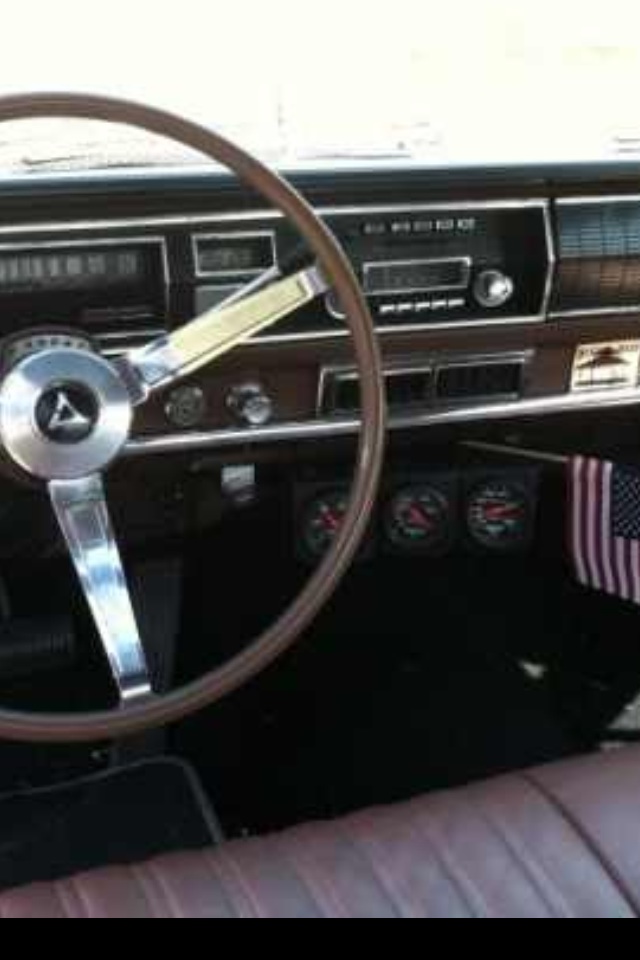

That blue inline crimp is mine. I tapped into the clock light wire for my oil pressure, engine and trans temp gauges.
