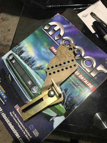

[QUOTE"1967coronet440, post: 910842114, member: 26011"]Which bracket do you need bill? I have throttle plate and kickdown linkage mount, also have the cable itself.
View attachment 551657[/QUOTE]

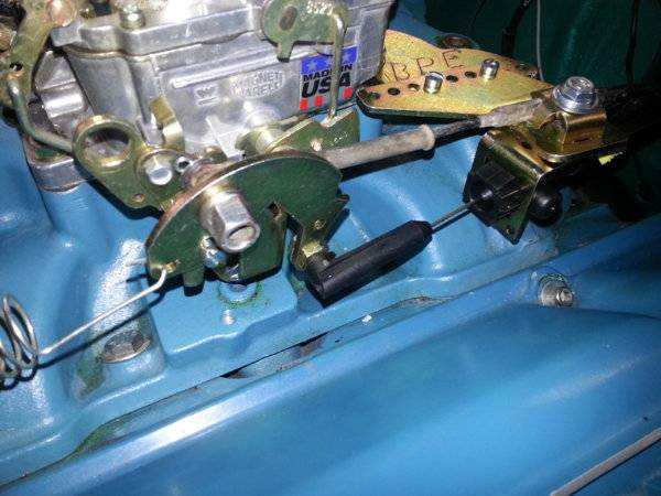

I saw your ad right after I placed my order. Thanks for the offer.
Job is completed and I'm happy. The only 'do over' was placing the kick down cable ball on the carb. I started with the ball facing the carb, but could not get a direct angle (measured 30 degrees). Moved the cable ball facing the fender and get less than 10 degrees angle on the cable. Nice set up and quality is excellent.
Many thanks to Threewood for being my tech support hotline during the installation!
