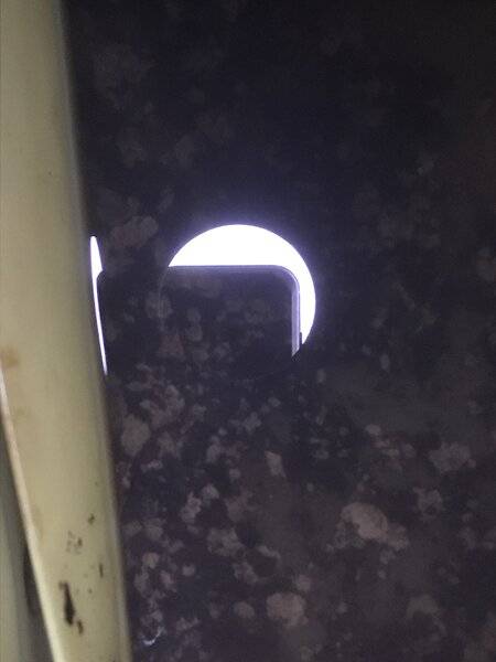

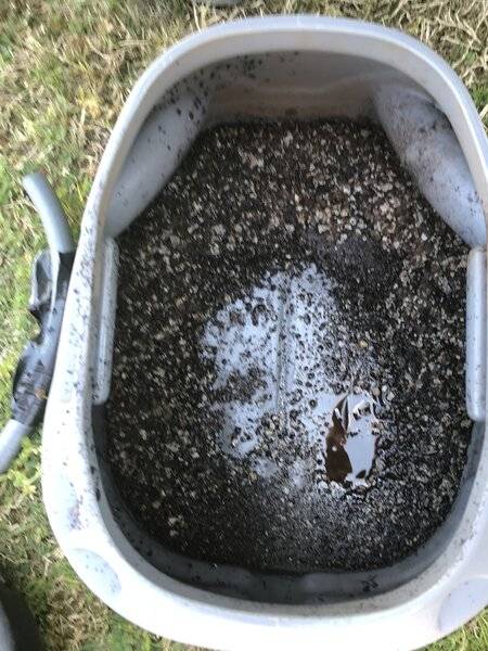

I had a younger kid I'd say in his early 20's knock on my door and he was saying that one of the other guys in the neighborhood said I was the guy to come and see about his truck sputtering and stalling. Well, we got it started and it ran but was running out of fuel. I checked both filters they blew through fine. THen I checked the electric pump it was fine. I put a see through filter in place before the pump so I could see what it was doing. It pumped the filter full in a few seconds I was like hell take it for a spin. Well it died again around the corner and they towed it back to my house. I saw the filter was completely empty. So we drop the tank and low and behold the sock was gone off the pickup tube and there was soooooooooo much rust scale in the tank it could not possibly get gas. So I pullled the tank and beat the snot out of it and vacuumed it out several times beat and vac beat and vac till no more scale came off.
Made a make shift sock out of a piece of fuel line so that even if the big end of the hose gets clogged it could still get gas through all the holes I drilled into the hose. He ordered a new gas tank but its 3 weeks out and a new pickup. So for now its up and running. Just a shame how much rust was in that tank.
