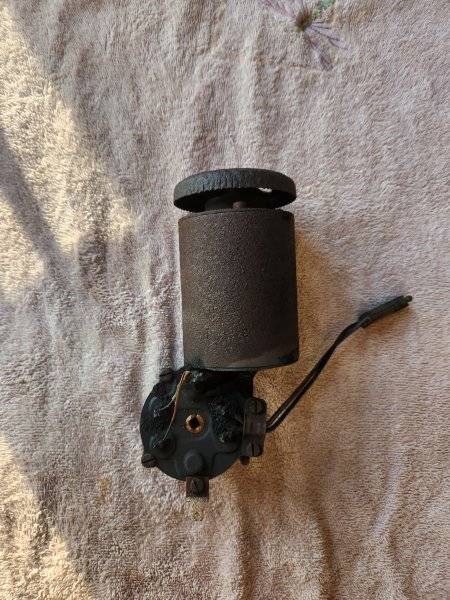

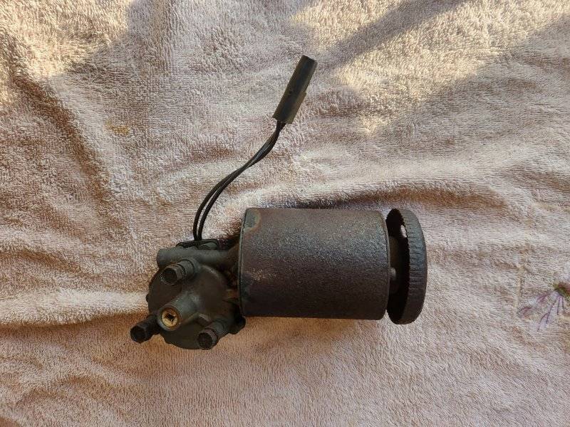

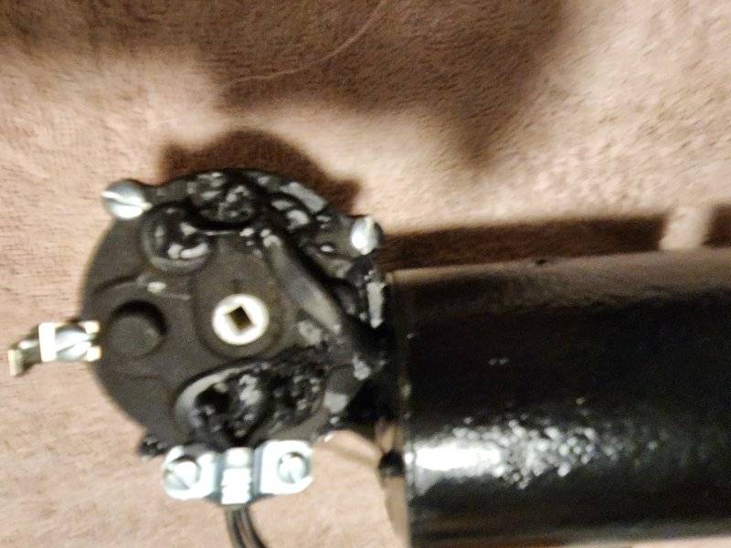

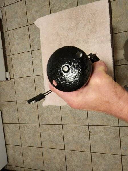

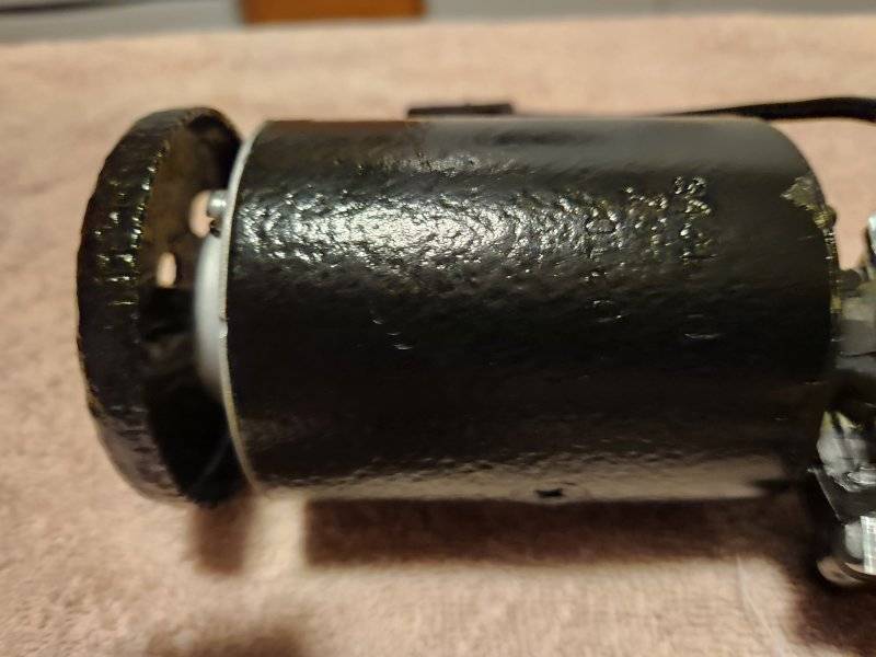

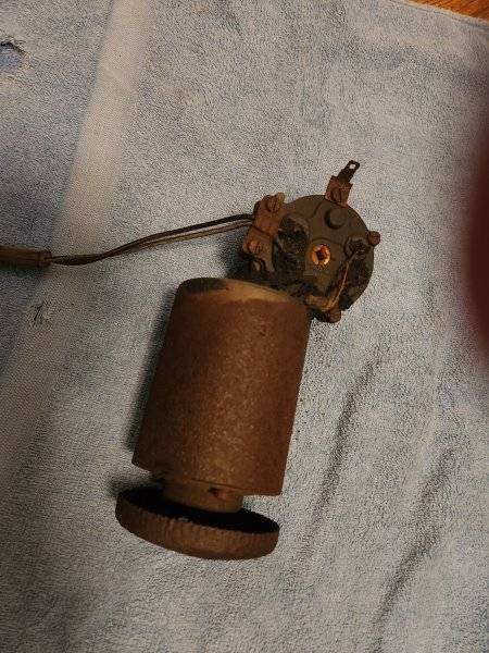

This is before and after pics of my headlight motor. I felt that the housing and knob should of been glass beaded/sand blasted. Am I wrong? $375 was told 4-5 weeks,3 days after he got it he called and said its done.

Don’t know what originals looked like, but 66-7 motors were nice and smooth not like your housings. 2nd gen guys would know,\.
Pictures are hard to tell. It looks like it was rusty' heavily pitted before you sent it. If that's the case bead or sand will just remove the scale and not the pits. What did the rebuilder tell you he did?

If so, possibly that could have been sanded smooth before paint.

Uhh, no.
Pits in the surface cannot be sanded out because they are areas where the metal rusted away. That wiper motor was heavily pitted before the rebuild. It would be unreasonable to expect the rebuilder to do what equates to "bodywork" to the housing unless it was agreed upon beforehand.
If it functions properly, maybe consider a wrinkle finish paint to disguise the rough finish. I'd be okay using it in one of my cars if it functioned right.
My experience with these type motors and wiper motors is the rebuilder will tell you what he can do. A poor core will never be that great when done. Again the rebuilder should of discussed this with you before he started. I do not think that knob can be sanded out to be smooth. The barrel is hard to tell. For sure it does not look good.

Looks like it needs a coat of body filler. Hope he did more than just paint it for $375.
The barrel and knob were heavily rusted and pitted. The only to make those look nice would be to blast them down to bare metal, prime and block until they are smooth and then paint them. Basically, body work and paint.
Actually when I did one for myself years ago after disassembly I chucked the barrel in a lathe & took a light pass... Cleaned up 99% of the rust & while the stamped numbers were lighter they were still visible...
