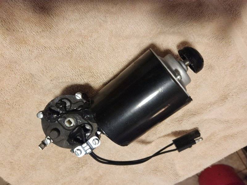

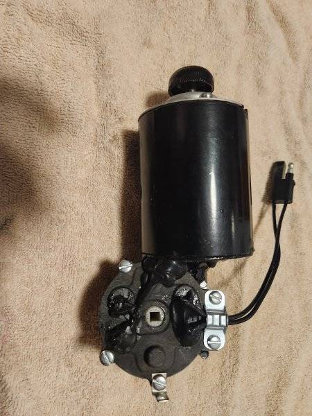

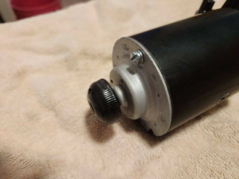

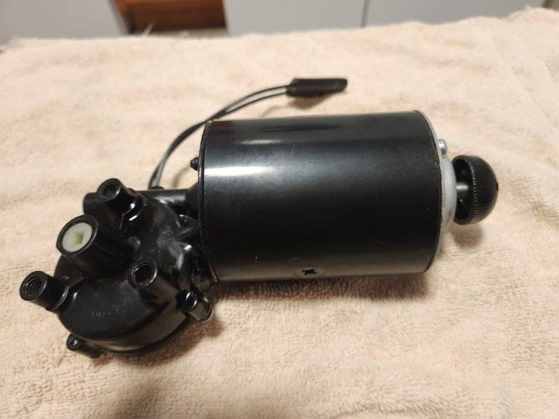

your opinion please - just received my restored headlight motor
It was nice meeting you in person Dave!
There are definitely 2 views of the original question by Dave. This is my view(which Dave and I discussed last night):
9 out of 10 times a headlight motor won't be seen, but needs to function properly. I install new brushes, a new Torrington bearing, new gear(I own the mold to reproduce them), new gasket and a new harness/plug assembly. Each motor is bead blasted with 80 grit glass bead to preserve numbers and even blemishes, then painted with PPGs industrial line of paint-ALK 200 which is far better than a rattle can. So, I don't frown upon rust pits on headlight motors as much as I do on wiper motors.
Topher
That was my point in my first response here. If the goal was function over appearance, there would be no issue. For many cars, this is true. For a car destined to present well at shows, it would be unacceptable.
That housing and knob were ugly to start with.....blasting them only made them worse. The paint looks (to me) like it was an attempt to cover it up.
Again, for a driver or an average quality build, it would be fine.
Vender should’ve discussed when core arrived, OP should’ve asked or disclosed a rusty core and the expectations upfront.
Yeah, I can’t believe he bought a 70. Especially this one. Lol
well got my headlight motor back today. All I can say is thank you Topher it looks brand new. :thumbsup:
pics to big will load tomorrow :BangHead:
That is fast service. I think that your attitude made the difference.
A rude and entitled customer might have incurred some bad blood and a series of insults back and forth.
I'm glad it worked out well and quickly.
