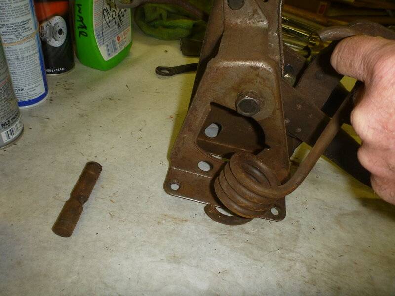

All done thank you all so much! Little more than 5 minutes...LOL It took care of my inconsistent adjustment problems and most of my noise which Im still sure the header is till touching the torsion bar just a bit und low torque. I will keep working on that. Im am still interested and would like to know more about the spring on the clutch pedal inside the car. Mine creeks is that why you would remove it? Thanks again....Matt "the axxmann" MacDermaid....www.axxmann.com
If the pedal over center spring creeks spray some grease on it... spring has to be there for a Borgs and Beck clutch, but with a diaphram clutch it needs to be removed.

Maybe with a Roadrunner instead?....LOL...How do I remove the spring?
Do you have a diaphragm clutch plate?? The spring needs to be there if you have the stock(ish) style B&B pressure plate.
With the clutch push rod disconnected and pedal down to the floor you may get the spring retainer pin out. It has slots to retain it in the inboard oblong hole.
Ok thank you but why am i doing this....what are the problems if I dont? Just askin?
IF you have diaphragm clutch the peddle can stick to the floor. You NEED to know if you have a diaphragm clutch. If don't leave spring there.
Another way to remove spring is have some washers, push clutch pedal to open coils put washers between coils.
