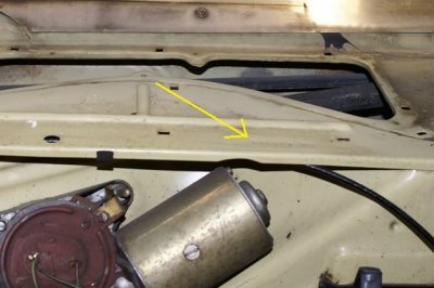

so after looking at my car I noticed the vin on the dash and the numbers on the rad support are not the same.I have a 69 RR convert am I to think the support was changed? Will those #s tell me anything on the support or are they just sequence #s
match....
If your looking in the right place, (driver side, engine side of support,) the numbers should be 2 digits, a space and then 6 digits, Stamped upside down which will match the last 8 digits of the VIN.
If not matched then, baring a factory screwup, either the dash VIN tag has been changed or the core support has be changed. There is also the fender tag number and left side trunk rail number to consider.
location of cowl body number for 3rd gen b bodies , I've noticed they seem to be left out of most of these sort of threads . still can't figure out why :eusa_think:
