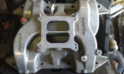

Just my 2 cents from experience..and using those 6 pack pistons. A Thermoquad intake is equal or better than that Weiand you have.:angry9:
the reason I planned on using the weiand intake was because it came with my 440 when I bought it. if it isnt going to work for me I wont hesitate to replace it and put it up for sale it was kind of a freebie so Im not in love with it.
air flow on those heads will peak around .450 lift, unless you do some serious re-working (porting and bigger valves). so why a high lift cam? anything over .480 lift at the valve on stock heads and you need to take a serious look at retainer to guide collision. you don't state what your intent is for the engine but with the parts you have i'd get one of those big summit cams (i believe they are the crane hmv278 profile). should work fine with stock heads, stock valve train, exhaust manifolds, and 3.23 gear in a heavy car. i hate cam recommending posts, their sooo subjective.
How sure are you about that intake number? Could it be 8008? If it is, that's for a low deck. In either case, it's better than a stock intake. If it's a tall deck intake, use it. It will work fine.
This is the intake intake.jpg thankyou for all the help guys I definitely need it when it comes to this stuff as I have very little knowledge about this topic. I do realize that this is a very subjective topic and I am finding that there are alot of different ways to achieve certain goals its actually a bit intimidating lol. As far as my goals go they are fairly simple i think lol this is my first mopar and I love it and I drive it almost every day when there isn't snow on the ground that is. That being said reliability driveability are important and having some extra power is great too. Am I going to be drag racing at the nearest track on the weekends probably not but I would hate to put myself in a position to where upgrading later on to make it even more powerful is difficult or impossible. Maybe my goals need to be adjusted a bit lol I'm not sure that's why I rely on the experience and knowledge from the guys who have been there before.

That's a great intake. Use it.
