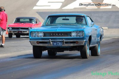

My 11 sec combo.
68 Coronet 440, 4000lb with me in it.
Engine 470 low deck
Source heads with very light intake port work
10.6:1 compression 91 octane pump gas
M1 single plane maifold
Quick fuel 950 carb
1.5 rockers
125gph mechanical fuel pump
1 7/8 Hooker competition
Running a solid flat cam, Comp XS290S dial at 112 maybe a bit too much retarded ???
3in dual exhaust with super Turbos mufflers
Manual body valve Fwd pattern.
FTI 9.5in 3800rpm converter
3.73, 8 3/4 rear
Hemi leaf spring with extended pinion snubber.
275/60r15 Nitto NT555R
The car has everything stock inside, still running 7 blade fan and power steering.
It ran 11.81 at 114mph car is street driven and except it is a pig on gas it is quite streetable
It should go faster this summer, getting more porting on the heads, steeper gear, 1.6 rockers and mayber a solid roller cam like an XR286R but not sure yet on the cam. It will depend on the flow we can get from the heads and also if i can convince myself that a solid roller cam can survive on the street, I am worried about the lifter themselves, any good or bad experience with solid roller lifter doing maybe 1000 to 1500 miles and 20-30 runs per summer ?

I agree thats a nice looking and running Coronet ! Ron
