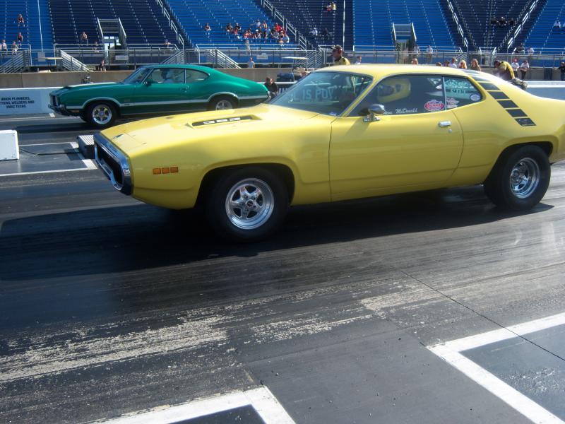

View attachment 156298Best of 11.401 @117 stroker 498 906 heads .mildly ported C&S race carb 557 lift cam mopar perf. adj. rockers rev man.shift trans 727 83/4 with 430 gears and a spool weighing in at 3940. Glass fenders and hood .In street trim 11.79. Drive it to the track, switch tires and go rounds!
Beautiful car, I'm shooting for similar build. How do you like a spool on the street?

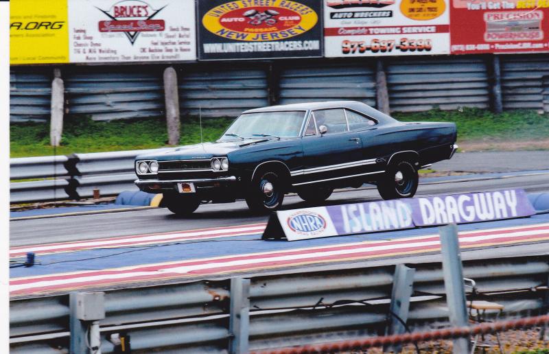

IMG.jpgHey Guys, I respect your opinions and would like to get some advice on getting my car into the 11's. I have a 68 GTX with a 440 .030 zerodeck , cnc'd stealth heads, appx. 11.1 CR, old offenhauser 2x4 intake, 2- 500cfm eddys , 1-3/4" headman headers w/2-1/2 exhaust x-pipe and cutouts. Lunati hyd. roller 231/239 @ .050 535/550 lift, hughes 1.6 roller rockers, forged crank and pistons, h-beam rods, 7 quart pan with 1/2" pickup. Torque converter is stock w/ reverse manual valve body 727, all stock suspension ( ss springs in back) , 8-3/4 w/3.55 and locker rear. 275/60/15 BFG (bald) out back. The car has run a best of 12.64@112.45 with between 1.9 and 2.0 60ft. times. Over the winter I plan on slicks, adj. shocks front and back, adj. snubber, torque converter(suggestions) moving battery to the trunk, and 4.10's for the rear. I built the car originally to look and sound cool at cruise night, but now I want more speed for the track. I still want to drive on the street, but the track has now become more important to me. Let me know what you guys think.
Thanks, Bob

View attachment 156995Hey Guys, I respect your opinions and would like to get some advice on getting my car into the 11's. I have a 68 GTX with a 440 .030 zerodeck , cnc'd stealth heads, appx. 11.1 CR, old offenhauser 2x4 intake, 2- 500cfm eddys , 1-3/4" headman headers w/2-1/2 exhaust x-pipe and cutouts. Lunati hyd. roller 231/239 @ .050 535/550 lift, hughes 1.6 roller rockers, forged crank and pistons, h-beam rods, 7 quart pan with 1/2" pickup. Torque converter is stock w/ reverse manual valve body 727, all stock suspension ( ss springs in back) , 8-3/4 w/3.55 and locker rear. 275/60/15 BFG (bald) out back. The car has run a best of 12.64@112.45 with between 1.9 and 2.0 60ft. times. Over the winter I plan on slicks, adj. shocks front and back, adj. snubber, torque converter(suggestions) moving battery to the trunk, and 4.10's for the rear. I built the car originally to look and sound cool at cruise night, but now I want more speed for the track. I still want to drive on the street, but the track has now become more important to me. Let me know what you guys think.
Thanks, Bob
the changes your planning should get you into the 11's pretty easily, as long as you have adequate fuel supply & good hot ignition & can get enough traction, the gear change & converter {3000-3800rpm stall, will still be streetable, with the 4.10:1 gears, give you a better 60ft time which equates to a better 1/4 mile ET} will help allot, slicks or drag radials are also a good idea, lighten the car when your at the track, take out everything that you don't need & go on a day with some cloud cover, that's not too hot will help some too... good luck
Thank you! Spool isn't too bad unless I get caught in the rain. The occasional car show in the grass is a bit rough too but over all no issues .
Thanks, Bob
Wow, looking back to the beginning of the year, all I added to my combination was 4.10's, torque converter and shocks. Went from a 12.64 to 11.52. I know there's more in there to be had.
