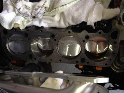

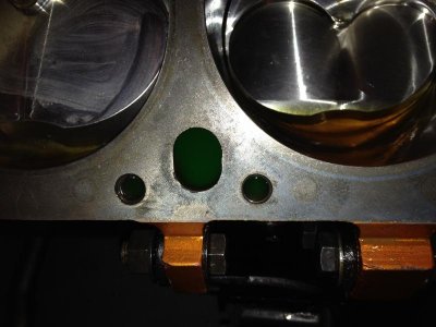

If you are in fact using the correct head gasket 8519PT1, then I would look at a surface defect on the block. Either a low spot around a coolant passage, or the surface finish is too rough if surfaced. If someone got too aggressive when using the 3M scotch pad, it will actually wear the metal away creating a low spot. When you take the heads off again, take pics of the surface and post them.
Sorry, that was a typo....they were the 8519PTI's. As far as what they looked like when I pulled the head, too hard to tell as they were soaked upon taking the head off since the cylinder filled up with coolant.....it did look like it was sealing around the bore as I could see the rings in the block and the head. Here are a couple of pics of that water jacket....nothing looks to be abnormal that I can see. I did see that Edelbrock recommends a Fel-Pro 1009 for aluminum heads....I am going to order up a couple different gaskets (this 1009 they recommend) and a multi-layer to see if it could be just the 8519 causing it....seems odd but sure would be better than ripping this back down.

Back up a little more so we can see the entire surface. Also, as far as the rafter square goes, it is not an accurate straight edge, and it is too short to properly measure the deck. You need to use a minimum of a 24" machinist straight edge. The machinist straight edge has been ground to about 0.001" tolerance over its entire length, where as the rafter square is, well, a Lowes special...

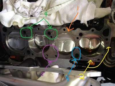

It is definitely a lowes special! Here is another pic with a wider shot....not sure how well you will be able to see it on here but it does look like the gasket is not sealing well around the upper water jacket to the top right of #4. I did borrow a deck plate from the machine shop today and tried a couple of different gaskets....although they sealed better, still have some leakage into #4. Unfortunately I cant tell where it is coming from and still no visible cracks. At this point it looks like a tear down and off to the machine shop...
This is what I kind of see with this pic...
1) This looks to be combustion or oil staining
2) These look like low spots as you can see no gasket transfer
3) Water marking a large area, possibly a low area also
4) Not sure what to make of these wierd shapes next to the water jackets
5) There seems to be a lack of gasket transfer here also
Your earlier pics look as though it might have been milled before, and it could be too smooth. A Fel-Pro composition gasket shoud be somewhere around 60 - 80 micro inchs RA. The MLS gasket you are getting wants somewhere in the low teens. The info sheet that comes with it should tell you, or the Cometic catalog will. Take it to a machine shop to check it for flatness, and depending on the gasket you want to use, have the surface it correctly. I see no other obvious reasons to leak water.

Thanks Dave....you picked up a lot just from the pic! I thought those shapes (your #4) were very odd too....they are actually on the other side on the block as well where I am having no issues. Should have it to the machine shop Monday to see if they can correct this!
Only way to really fix this right is to pull it apart and take it to the machine shop. The deck of the block doesn't appear to have been machined recently, and it is prob not flat. The Block Shop in Denver did all my work on my 451 and a 383, no issues. Have them check it and the heads for flatness. That 8519 gasket should work well. I used steel shims, and no leaks. Has to be a warped deck or maybe a head. I will send you a PM and you can call if you need help, I live in the L Wood area. Not far from you. Good luck.
