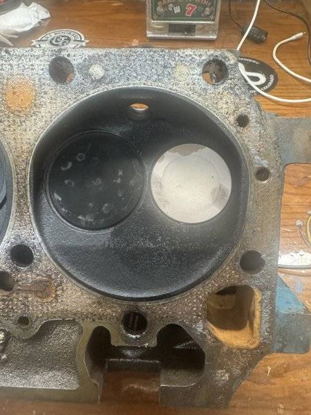

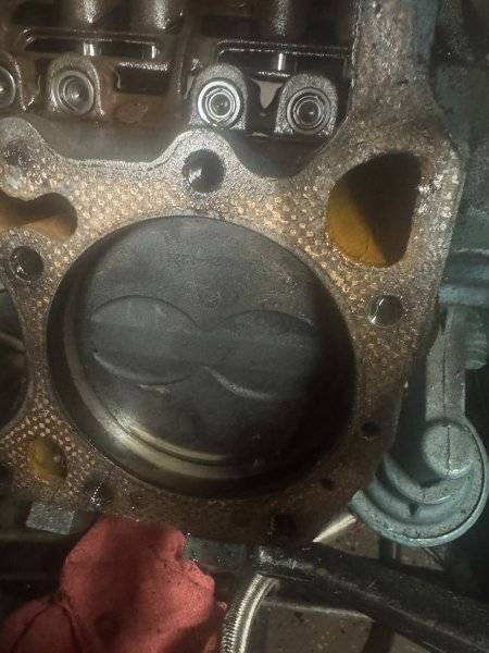

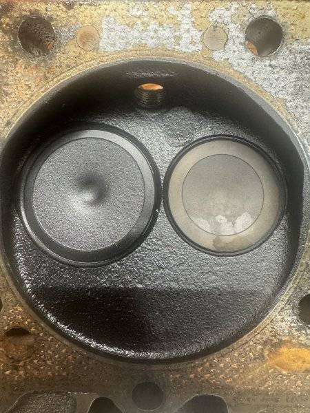

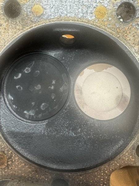

One white valve
Did you check that the exhaust valve is sealing good? Pour some low viscousity fluid like solvent or alcohol, or brake cleaner in the exhaust port and see if it leaks past the valve seat.
fillled both sides of the valve with alcohol and both sides held it for over 5 min with no leaks

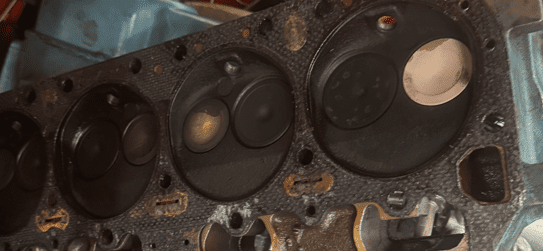

the water jacket appears to be casting flash in that picture. But obviously no way to tell from the picture. I agree with you that your best bet in this situation would be to reassemble and test. Had many radiators come in the shop that would hold 15psi cold, but as soon as they had heat in them wouldn’t hold pressure. I wouldn’t rule that out in the head either.
Is that a head made before or after 1974, when they switched to unleaded gas? The old heads don't have hardened seats as they depended on the lead in the gas to cushion and protect them. If you have an old head and are burning unleaded pump gas you could have cracked the valve seat.
I just quickly read this series of posts…I dident see any mention of magna fluxing the components. Find a reputable machine shop. If there is a crack you will know immediately if not sooner. It is definitely antifreeze that is burning. Did you smell the exh, you will know the smell of burning coolant.

~ The valves and valve seats were updated when the engine was rebuilt during the build, I also tested the valves with some alcohol, The "white valve" held the alcohol for several hours with no leakage.
~ I plan to upgrade to some different heads once I determine the real issue (if possible).

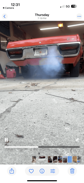

~ I'm 100% confident that the car wouldn't start smoking until the cooling started to pressurize and it would get worst under load.
~ Already talking to the machine shop that did the original work on the block and heads. Trying to avoid pulling and disassembling the short block if possible. They want me to bring them the head so they can rule that out before we go to the next step.
~ The car wasn't raced or abused and it has less than a mile of use after it started smoking.
~ Question, which I think I know the answer, do I need to use a new head gasket and head bolts for the initial cooling pressure test or can I use copper spray on my original suspect gasket? Not planning to start the car,
I did a dye chem test (Cantesco) on the head and cylinder and didn't see anything

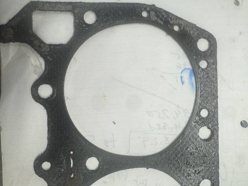

Possible bad head gasket. Check the block and head with a good straight edge. Probably it's good just being machined recently. Use a good quality gasket. Torque it properly then loosen and Torque again. You'll get a little more out of it the second time around.
Good luck!
Did you check the valve guide and bowl area on the white valve? Is the valve white on the backside also?
Good luck!
white on both sides

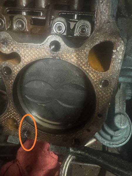

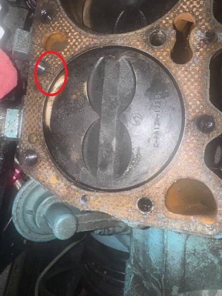

Unless I missed something, I dont see any dowel pins in the block to head. I had a coolant leak from that area from the head not sitting down completely so maybe if they are missing its causing a problem?
I’ll take a look, engine has been running for 5+ years with no issues. Thanks for the insight.

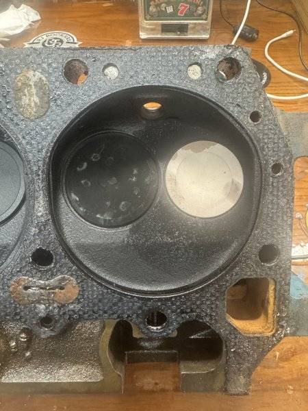

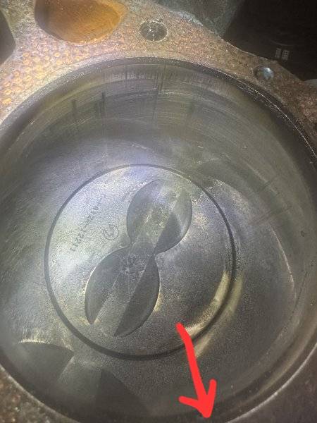

The head passed the mag pen and pressure testing at the machine shop and they couldn't find any issues. This leaves to either simply a bad head gasket or a block issue. My plan is to reinstall the head and pressurize the cooling system. (should have done this before removing the head). At this time I'm not planning on totally reassembling and starting the engine.
If I'm only pressure testing the cooling system can I use the original head bolts if I don't plan on starting the engine? Will a new gasket and original bolts work for this head gasket cooling pressure test? My other thought is to use new bolts and if it passes the pressure test move forward with reinstalling the exhaust and ignition, starting the car to see if it still smokes. The stock manifold and plugs are a pain in the a&#^ .

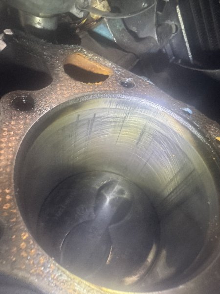

Forgotten whether you put a straight edge to block deck surface, I'd do that if you didn't. Put Hi Tack on your new gasket, clean bolt hole there are tools for that but a bottom works. You don't want false torque readings. I'm there are suggestions.
Thanks, the machine shop checked the head and I need to check the block
thanks for the feedback on the dowel pins. I do have one on the rear of the block but the front is missing. However it doesnt appear to be part of the cooling jacket on the block or head. do you think it could still be contributing? If so, where can I get a new one?
A parts store or a machine shop may have them. Amazon Granger McMaster Car.
update, dowel pin replaced, reinstalled new head gasket and pressur4e tested the cooling system with an auto parts store loaner test kit. Pressurized to 17 PSI and left overnight, next morning it read 16 PSI. The rediator is full but I had no way of circulating the water. Is this one pound drop at ambient temp a concern?
Pics
update and a question . couldn't find a smoking gun, the head tested ok so I reinstalled the head, new bolt and gasket and no smoke. It appears the headgasket was the issue.
now for the question. Prior to the smoke, the car had developed a misfire, not terrible but apparent. changed plugs, wires, distributor cap and rotor didn't solve the problem. measured the temp of the header pipes with my laser thermoter to see if one of the cylinders wasn't firing.
Based on the temp test it appears that cylinder #2 isn't firing(this was the white valve cylinder) It stayed a few degrees abvove ambient while the other 7 heated to 170+ for the short test. Then I systematically replaced the wire and checked the spark before installing the plug. My self taught mechnical mind says I need 4 things to heat the cylindar 1) Fuel 2) Air 3) spark and 4) compression.
