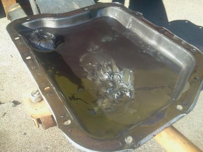

opening it up today and doesn't look good.
Two bad rebuilds and $1322.90 later.
She's making metal ... can't tell by the picture, but what does the fluid look and smell like? I restore Mopars for a living and work for a high end shop, I do a lot of 727's (four in my shop as I type this). All the ones I do are already removed from the car and I install them when the car goes back together. My "on the bench" price for rebuilds/alumi-blast paint finish and less torque converter is $675 ... when I have to bead blast the case/re-stamp/detail of all fasteners (and make sure the case is perfectly clean inside - this takes a lot of time) I then charge $1000.

No, that doesn't look good, looks similar to what I had in my 727.
In my 727 they had assembled it without the thrustwasher between input and output shafts, causing steel to grind on steel. The steel fragments mixed with oil caused the sprag inner race to grind a fairly deep track in the 727 alu-case, making a repair kit and machining of the case necessary.

Nope it is the right metalic burned red for a bad 727. The car has a trans cooler and does not go through the radiator. I am not a big fan of mixed fluids so I deleted the mixing possability as an extra precaution.
