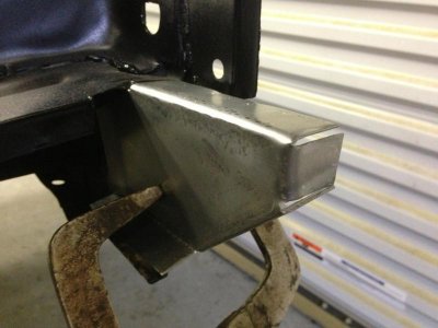

Trunk Floor Patch Work
Today went rather well. I was able to form the patch panel and weld it in. It will require just a small amount of body filler to make it undetectable.
Follow along, and I'll show you how I did it.
Here is the rough outline of the patch after I cut it out of 18 gauge metal. Here you can see how I made alignment marks for the rolled reinforcements that were in the original part.
Remember the wooden shaping form ??? I secured it to the metal patch with sheet metal screws and washer, so that it would not move while I was hammer shaping the recessed areas.
Once the recessed area was done, I bent the edge at a 90 degree angle to the floor. This gives it the proper edge for the trunk floor extension to weld against.
The final bend was a slight one. The original part had a little bend in it about 1/3 of the way from one end. This allows the part to follow the frame rail contour.
Then I positioned it in place and marked out the areas where the rear leaf spring support was spot welded against the original part. After that, it was only a matter of drilling out holes in the same place as the original part was spot welded in................
Here is the part as I was test fitting it to get the edge gaps proper. It is not in the exact position here just yet. It is pretty close though..............
Here the part is held in final position by the clamps. I really wish the gaps were just a little tighter in a few places. It made for a little harder welding the part in place later on.
Then I started tack welding it in position. I used the large vise grip pliers to hold the patch down tight against the frame supports underneath during the welding in the original spot weld places.
When you start tack welding, do one spot, and then move to another location, preferably on the opposite side, and make another weld. Right now, you just want enough to hold the part in place. You need a small gap, to help prevent distortion as the metal heats up while you are welding. Here you can see the gaps are a little too wide. It can be welded like this, but it is very easy to burn through the edge if your not careful. It happened to me several times while welding on this part today...............
Then I used a flap wheel to smooth out the tack welds, so that I could see how things were going. I also wanted the paint to be removed form the edges, to make a better weld.
You can now see some small pits in the spot welds. They were filled in by a second round of tack welding over the area.
Then it's a matter of welding in the areas in between the tack welds.... Keep skipping around and try not to get one spot too hot.
Then you start connecting the spots with a quick pass over the top of the tack welds.
Then when you think you have it good enough, grind off the slag and polish the metal down to where it is even along the edges. If you have any gaps or holes, simply go back and give it another tack weld in that place.
I gave the bare metal a quick spray in black to keep it from rusting. I painted both the top and the underside. The patch is now in place, and will require a little filler to blend everything in. Once that's done, it will get some undercoating on the bottom, and will be virtually undetectable when completed.
