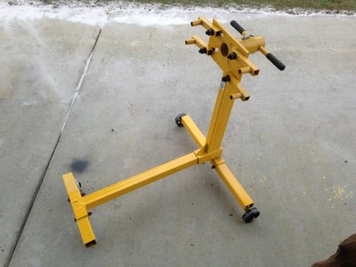

Today I cleaned up the trusty old engine stand in preparation for the "Home Coming" event. Also pulled out my rear end stands getting ready for the 8 3/4 set up work.
That's about all. Pretty boring uneventful day. Had to take care of some other things around the house.

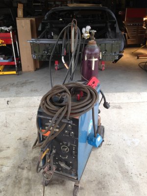

Today my neighbor stopped by to ask me to help him with his 57 Chevy "Gasser" project for a few minutes. He needed help with placing the 8-71 blower on top of the engine. He is the same person who let me use his 2 post lift to install the engine in the Duster. (a good neighbor to have, LOL)
While I was there he offered to let me borrow his Miller Mig welder. His welder is a WHOLE lot better than mine and has better adjustments. He said that since I am replacing the panels on the Satellite, why not give his a try. So we loaded it up and it's now in my shop.
I's sure there will be a learning curve, so I will have to practice with it a little before I actually use it.

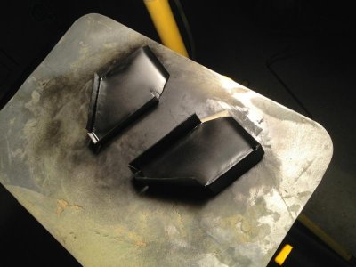

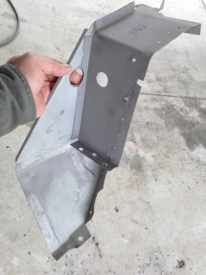

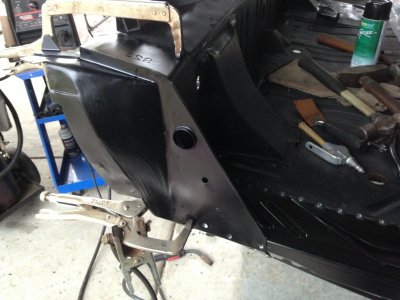

So I started getting busy with the parts I fabricated. They were glass beaded and then painted black. While they were drying, I glass beaded the end part that connects the quarter panel to the rear of the car.
Then it was painted too.

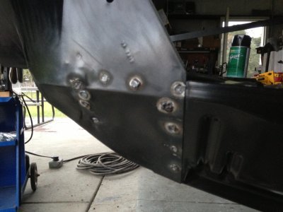

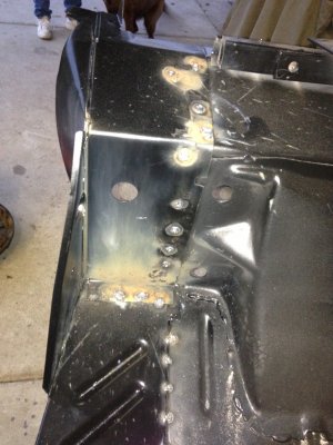

Then I started the welding. First I test fit the new part I fabricated to see how it worked. Luckily, it fit like it should. So I marked it out and clamped it in position. Then I plug welded it in place.
Then I fit the trunk floor extension and welded it in.
And just to be safe, I tack welded it along the top seam as well. This area will eventually be covered with seam sealer, so none of this will be visible.
Then I welded in the last part for the day.
These plug welds will have to be flapped down and checked for holes. Once that is done, and everything looks OK, then this side will be ready to hang the passenger side quarter panel. But that is still some time away from being done. I still have to weld in the same parts on the driver side, plus the wheel housings, and fabricate the parts for the roof sail panel reinforcement, before even thinking about hanging on the quarters.
So there is still much work to be done.

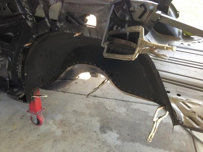

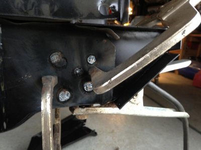

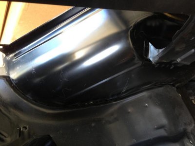

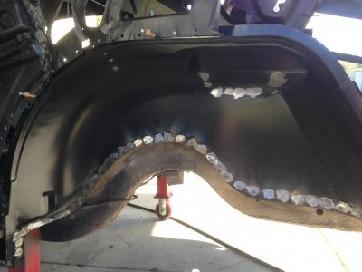

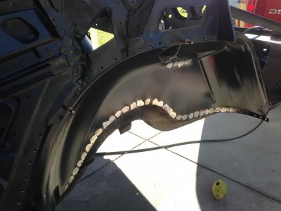

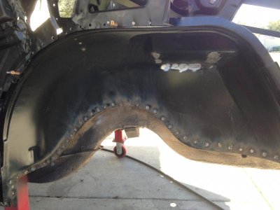

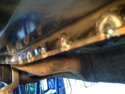

Today I made some progress on the Satellite. After some final fitting, I welded the inner half of the wheel housing in place on the driver side. The new sheet metal fit like a glove. (I'm happy to say).
After the initial plug welds were completed, I went back and ground them down smooth to make sure they were good and solid. A few still had pin holes, so I simply added another tack weld over the hole.
Here is a photo showing how nice everything is lining up on the seams.
