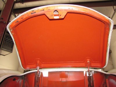

A new company came by and blasted the engine compartment of my dart, as it was in dire need. He used powdered glass and water, that blaster took everything, but did not warp anything. He even did under the hood, and the hood looked like new. The glass powder is biodegradable, and he came out to my place and did it on site.

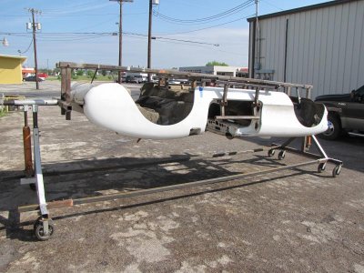

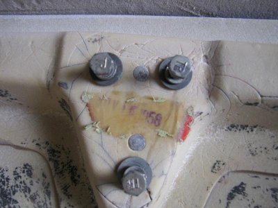

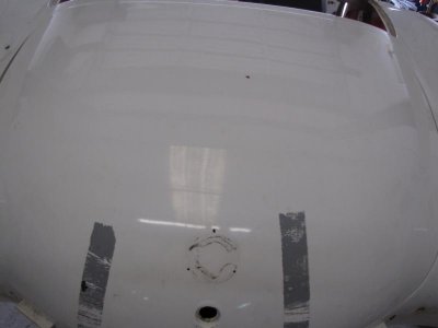

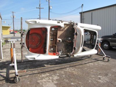

Here's some current goings on with my latest patient in for surgery. She has some damages that will need Post Operative care! But, this is a very rare, and valuable piece of American Car History; a 57 Corvette!

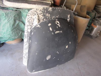

Took in 70 RR N96 440 4spd original Hemi Orange, guy bought it off ebay, seller said "it's solid", buyer bought it -- as he should because who will refuse this car, right? But...his bodyman started to chem strip it, wanting to see what's going on, found a few rusty issue and fixed them, but, handed me all of it, and the Door inside lower seam was not touched! One drain plug/hole was filled with Bondo, and skimmed all along bottom seam hiding some rust and crust!

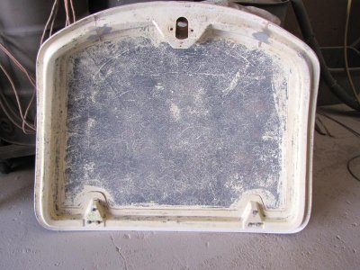

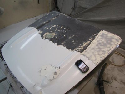

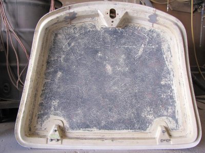

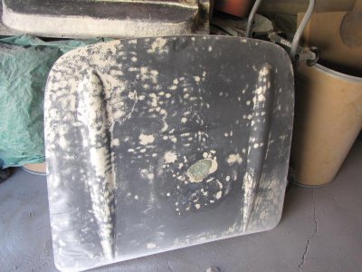

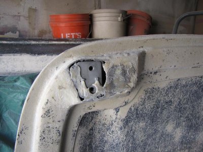

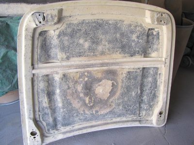

Deck lid; oofah! It was SO heavy, underside lip LOADED with Bondo packing into rust holes and the soft Bondo extending inside the Deck Lid, so, when I blasted it off, chunks broke off inside Lid, and they're 'floating' inside, Houston, we have a problem! The Chemically stripped sides (Top/Face) are slick metal, Media just slides off it just leaving some etch marks (which is not bad) but, the process works best when there's some paint to dig into, so...does this process really save the owner some money in time, etc? No. His time has to be valuable, right? I asked how many hours he has in it doing the chem stripper, he said a LOT, over 40, I told him for 14-17 hours I'd have the entire car, parts clean inside, underside, outside, no rust, no paint. He and the owner came around, and called me even before I could 'sell' this to them already done their homework, biting the bullet, and saying do it. It's unfortunate wheels are spun and money basically thrown away like this, but, it happens all the time. Too often, to the novice the service rendered by Blasting is money they don't need to spend because there is Chemicals and Sand Paper to handle those tasks.

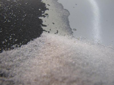

I think the media blasting still is the best bet with Dupont Star Blast. Except i like the idea of using it with water and collect the water to avoid the lead poisoning your getting from blasting either way. The Por-15 idea I personally think is a a bad idea. Remove the rust and protect metal from rusting is the only way. Donny I imagine how hard it must be in the suit especially on a Texas Sunny Day.
Star Blast is aka Powerblast, good stuff, very very dense and heavy, but, cuts wonderfully. I mix it in to about max 15% per total media blast used for a project; ie 3 or 4 55 gal barrels full of media. Having it at this mixture allows as fast removal of paint as possible, and as I encounter rust I can dwell in the area for a few moments really taking the rust off, remember this is all trade offs and balancing fast removal/cheaper costs for customer and in some (albeit rare times) people who don't want any etching of the metal well, they won't get this in this mixture. But, most of us car guys love the surface, epoxy lays down super nicely! But, please note, on Corvettes I use pure 100% Plastic, no Starblast or Powerblast at all! Suit is ok, I'm inside, out of the sun, but, even with an air conditioned helmet I still break a sweat in there often.

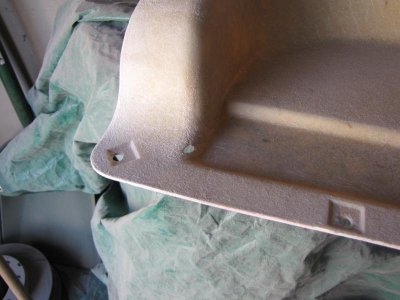

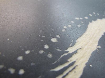

The black EDP coating MUST come off these parts before you paint them. I blasted a Hood for the above RR, it's brand new, it was painted Hemi Orange over the EDP. As I was blasting, the orange just blew off, literally blew off. The EDP came off easily too. So, take that EDP off folks, paint won't stick good.
