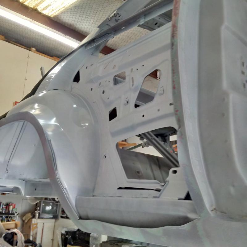

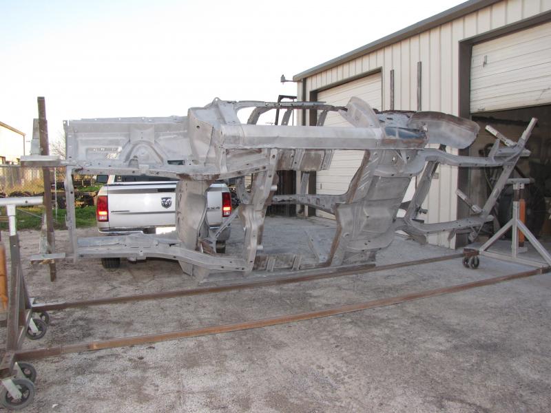

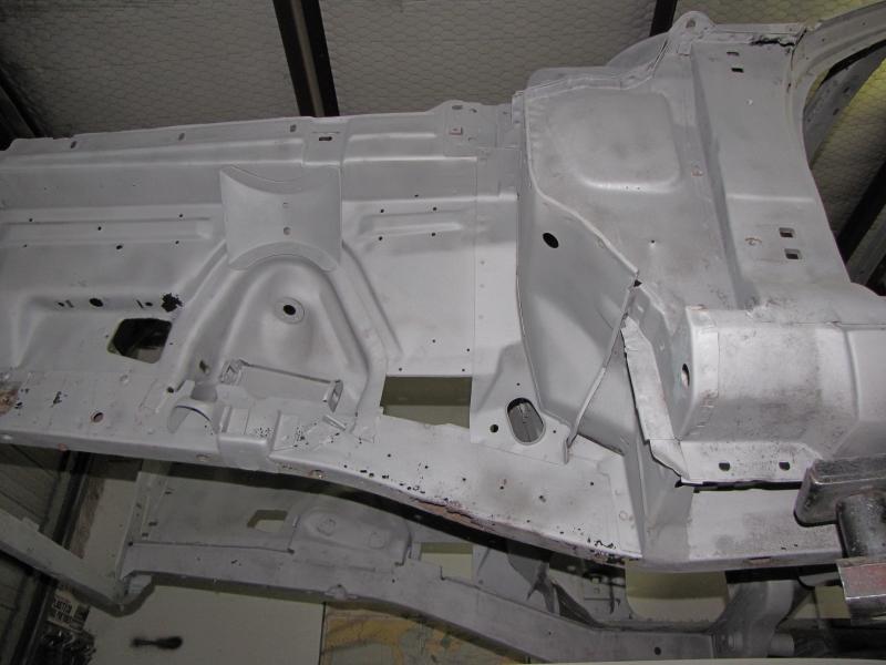

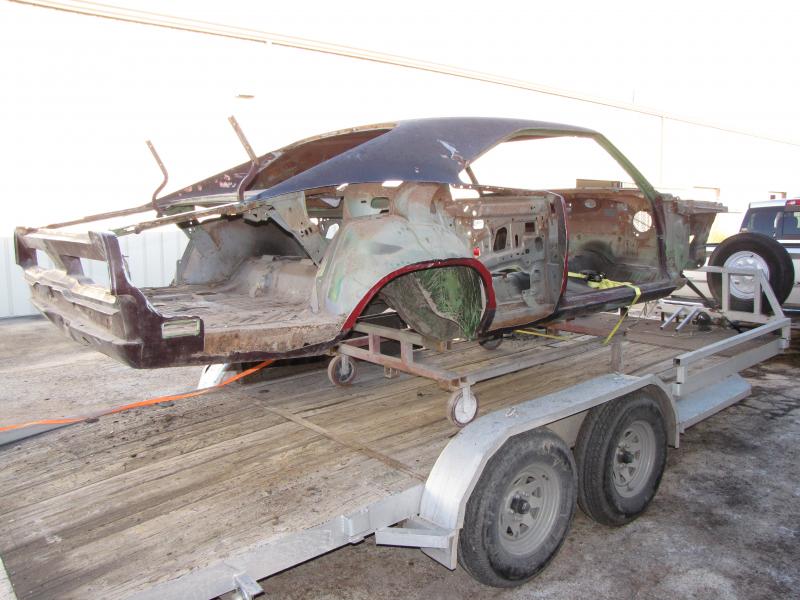

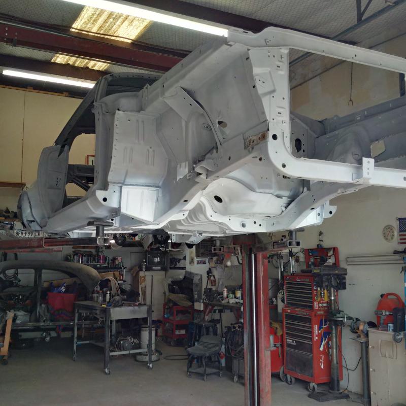

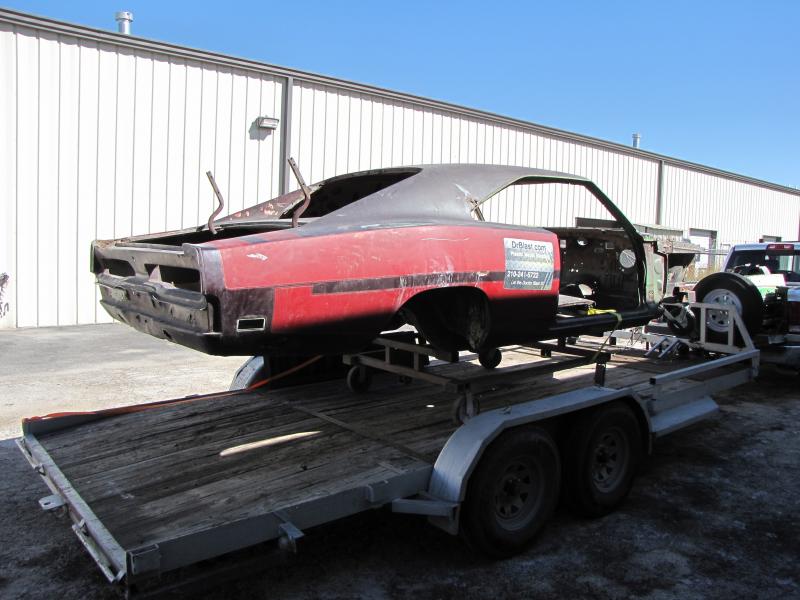

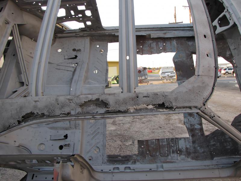

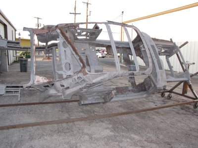

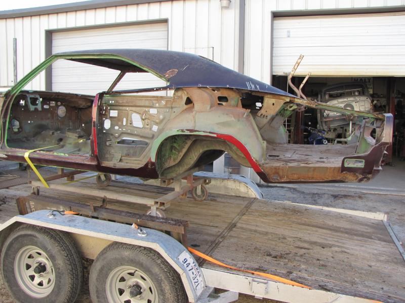

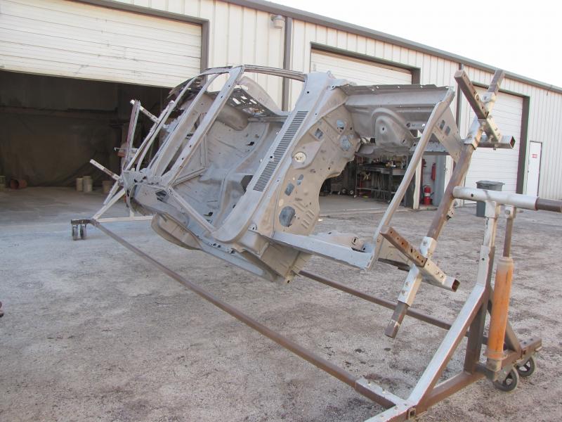

I welded some angle iron from the Frame rails to the top of the Inner wheelhouse where it flows into the C Pillar, you must do this especially since this car is missing its trunk floor, but has the floor under the rear seat. Rockers are good and solid, front frame rails are going to end up in the scrap heap. www.drblast.com

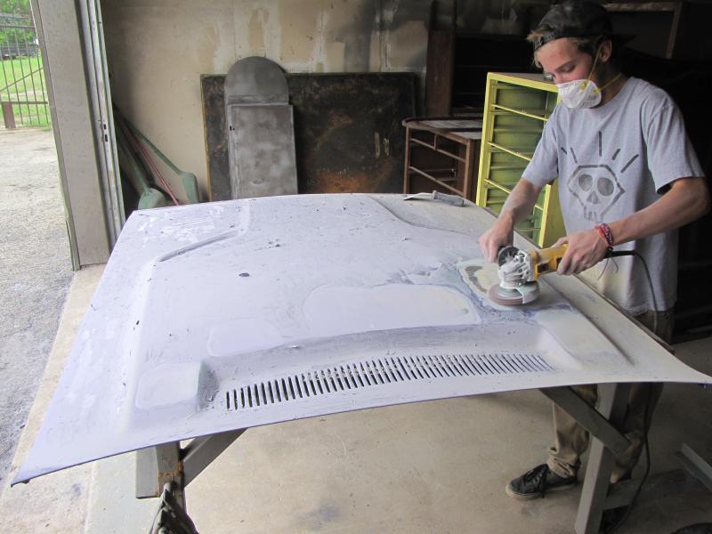

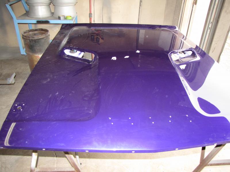

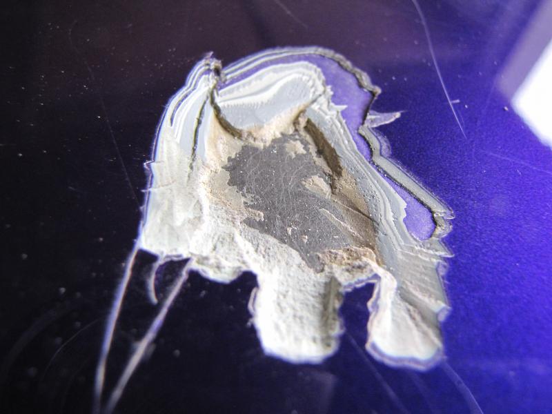

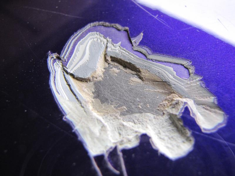

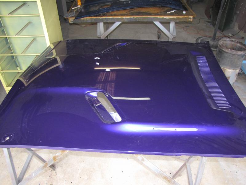

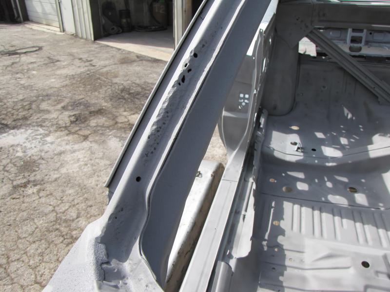

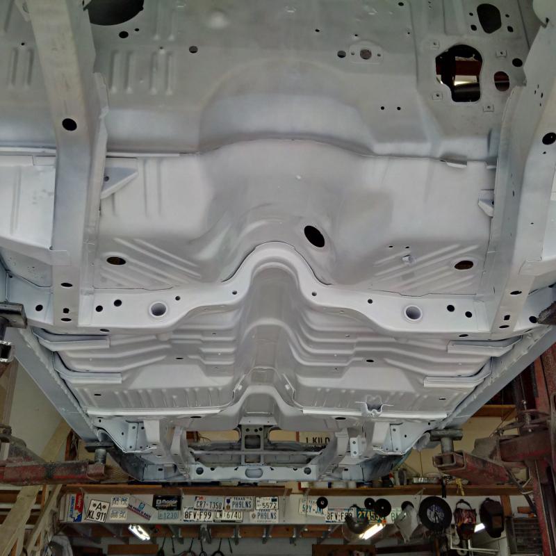

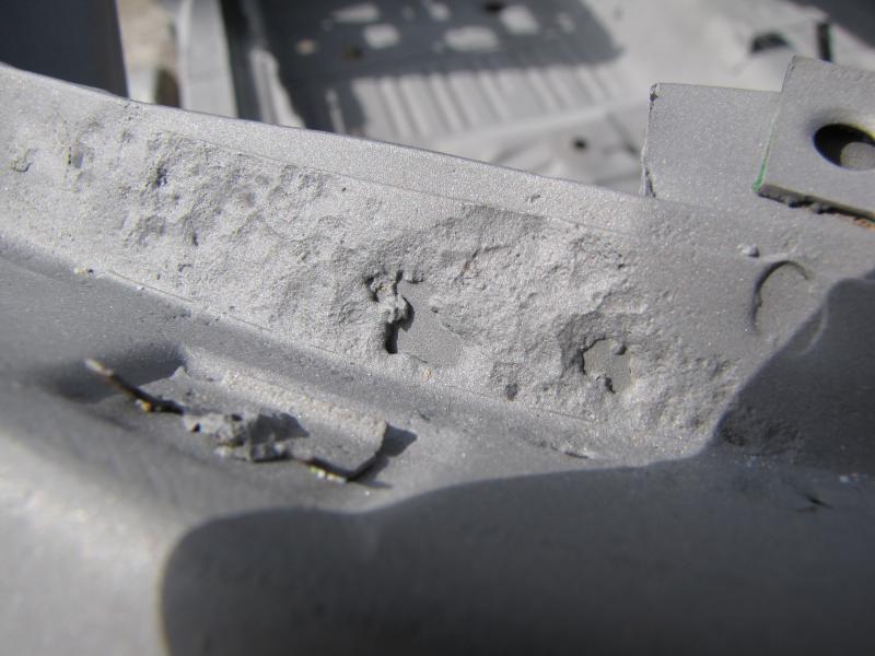

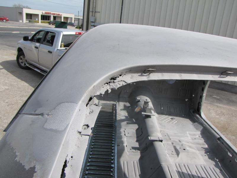

The black EDP coating MUST come off these parts before you paint them. I blasted a Hood for the above RR, it's brand new, it was painted Hemi Orange over the EDP. As I was blasting, the orange just blew off, literally blew off. The EDP came off easily too. So, take that EDP off folks, paint won't stick good.
