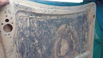

Folks, I've done a lot of cars with my Media Blasting apparatus. Today, I was finishing up a 54 Chevy truck. It had been painted sometime since leaving the factory with a nice Blue color, which actually looked pretty good! However, when I started peeling off the paint with my 20 PSI / 200 CFM Plastic Media Blasting system there was NO factory paint, nor primer. Some bozo years ago sanded it off, and put this Blue stuff on. What is problematic is the metal had flash rust on it, under the paint! My soft media does not cut into that too well, I added a bit of Alum Oxide to cut into it a bit to take it down to bare metal, it came out really good.
My point is, folks you HAVE to have your cars Media Blasted, only this way can you uncover the ills of previous 'expert' painters, body men, etc.
After tending to this Chevy, I went to my Satellite to blast the inner front fenders (see my pics in "What's Everyone Working On" thread). Here is where I show my ***; years ago, I bought into that hype of using POR-15. What utter **** this stuff is. I lathered it on thinking I could 'preserve', and encapsulate the metal in a preserved form. There is nothing further from the truth. I have only a little bit of this horrid **** to Media Blast off my Satellite then it's just paint(s). POR-15 is only good for ocean going vessels that are fighting rust all the time, not our nice MOPARS!
One word of advice; don't sandblast! It has too high a pressure, and, often we want to be backyard experts (I used to be this way) and, it takes too long, I remember taking all day to sand blast the inside of a hood, that was junk, I wasted 8 hrs just on a hood, the inside! Today, I do a whole car in 8 hrs, with soft media, low pressure, and expert handling!
Oh yeah, don't be afraid to take it down to bare metal, this is the ONLY way you can see what you have to start your build-up on your (our) dream cars!
