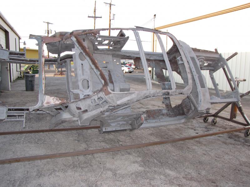

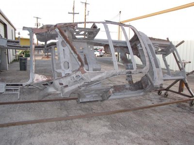

Donny...How is that hardtop on the rotisserie not bending,hardtops are weak,jack one up & see how the doors dont shut as good,well with the floor pan out like mine,its worse,cant even imagine it on a rotisserie without bracing...What music are you listing to Donny? Never heard anything like that

Donny...How is that hardtop on the rotisserie not bending,hardtops are weak,jack one up & see how the doors dont shut as good,well with the floor pan out like mine,its worse,cant even imagine it on a rotisserie without bracing...?
Maybe you are comparing a car with all it's heavy components (eng., trans., rear end, suspension, etc.) installed? Those components installed, add a lot of tortional deflection. Bring it down to a shell and what you mentioned goes away.

I have a 69 road runner(post car) solid frame but didnt have trunk floor or quarters on it I could watch it bow in the rear area when going on rotisserie off of lift,bare hull, Have a 67 GTX (hardtop) on all 4 tires floor pan is out of it,when I jack the front end up (under K-Member) the body flexs & doors dont shut good,sit jack stands under the frame behind wheels they shut good,when mounted so far out on a B-body I see flex on my post,Cant wait to see how much a hardtop flexs,with all body panels the cars may not flex but I think Im gonna brace between doors on mine first
thanks Cuda chick!
Anyone ever see those steel bridges sway in the wind? I am not concerned much for any of these old cars' flexing or bending. I won't hang a car in a Rotisserie unless it's a shell, I've hung them with no floors, no quarters, no roof with installed bracing in the *** end where the frame rails cross with the inner wheelhouses.
I doubt that it matters how much it flexes and wobbles. As long as it settles back to straight when you put it on the jig before the welding starts.
The 'Core' of these cars is the Rockers, the Seat Pan under the rear seat, and Inner wheelhouses as they tie into all the remaining webbing and structure.
