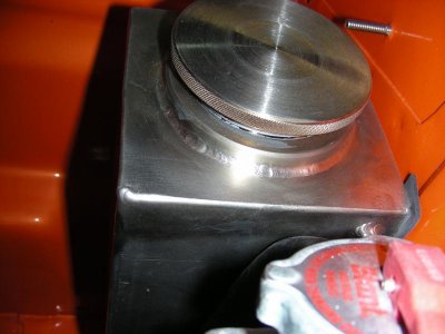

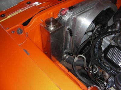

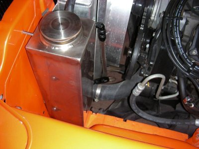

My Dad at it again. I was looking at the Charger trying to figure out what to do with the radiator for an overflow tank so it would quit puking antifreeze when he walked in "whatcha doin"? I told him I needed a tank and of coarse he says "give me a pattern and some dimensions" here's the finished product. It's stainless, has a big cap, bottom inlet, top overflow drain and it bolts right to the original holes. Pretty awesome I think. DSCN9651.jpgDSCN9652.jpgDSCN9653.jpg

My Dad at it again. I was looking at the Charger trying to figure out what to do with the radiator for an overflow tank so it would quit puking antifreeze when he walked in "whatcha doin"? I told him I needed a tank and of coarse he says "give me a pattern and some dimensions" here's the finished product. It's stainless, has a big cap, bottom inlet, top overflow drain and it bolts right to the original holes. Pretty awesome I think. View attachment 197658
Your dad is amazing . . . that is, by far, the coolest looking overflow tank that I've ever seen ! ! ! Your dad hit it out of the ballpark with that one ! !
Looks great 747Mopar . . .
From the looks of it, your amazing fabrication abilities are genetic , from your dad. Beautiful job for sure. Every piece of that car has been massaged, customized or tweaked. You should be extremely proud!
My Dad at it again. I was looking at the Charger trying to figure out what to do with the radiator for an overflow tank so it would quit puking antifreeze when he walked in "whatcha doin"? I told him I needed a tank and of coarse he says "give me a pattern and some dimensions" here's the finished product. It's stainless, has a big cap, bottom inlet, top overflow drain and it bolts right to the original holes. Pretty awesome I think. View attachment 197658View attachment 197659View attachment 197660

Thanks guys, glad you like it because I sure do and yes he is really good but as far as the genetics go I wish the apple fell a little closer to the tree in my case haha. I'm not trying to downplay myself he's just wayyyyyyyyyyyyyyyyyyyyy smarter than I ever will be. More progress to report, a trip to my buddies house landed me my missing rear view mirror (already painted and installed) and a set of original stainless wiper arms for a grand total of $20.00. With everything coming together it was time to put that damn windshield leak to rest once in for all, I really don't understand why the glass guy didn't do what I did because it was so easy and I'll almost guarantee it will never leak now. I just unzipped the seal, cut the tip where it was really small (butyl rubber in a caulking tube), pulled the seal back to where I could get the tip all the way down in the bottom, put a bead all the way around and zipped it back up. Once I had the seal locked back together I went around and added more anywhere it didn't squirt out. Clean up was a pain but it's done, now I'll finish polishing the windshield trim and wipers arms and install them as well. Hopefully I'll be back to the scoop soon.
