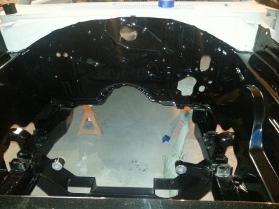

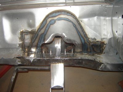

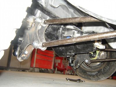

The suspension: I have the Martz chassis 4-link in the back and the Martz chassis front suspension.The front suspension came with sway.I got the welder series universal sway bar kit and fab it to fit the four link.
The Frame: I bought the front frame reinforcing kit from xv performance when they were still around and did the subframe connectors from Mancini.
The Drivetrain: The HEMI 496 CID World block Stage V heads The SuperchargerStore F1-A Procharger with the supercharger store water/methanol kit.
Transmission is a tremec TKO 600 a little on the week side for the torque the car produces.The clutch is a Mccloud twin disk I actually got the very first one he made for the 101/2 flywheel.The rearend is a 8 3/4 braced housing with an aftermarket 489
case 3.73 gears and moser axles. Wilwood brake front and back.

I will posts some pics of when I was doing fab.
If you look close at the car there are small details that I did that are hard to notice.
When I get the hood done I will take pics of the grill I made.
