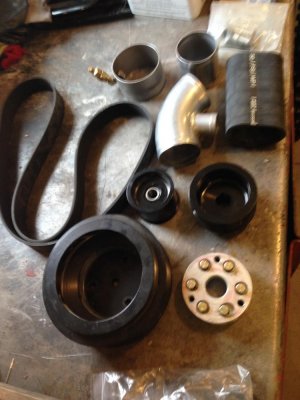

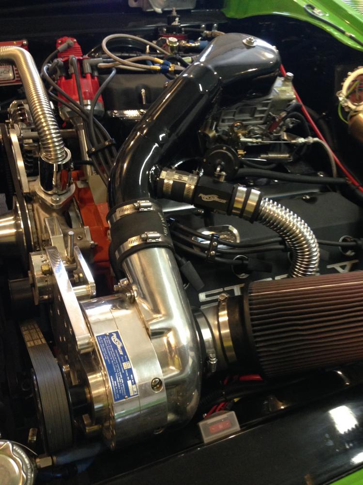

Hey Mike,The carb hat is the the standard hat that came with the kit.It fit under the hood when I had the 440 in the car. I had the hat and tubing powder coated black it comes raw aluminum.I did the fab work on the tubing and I am still working on my aluminum welding,thats another reason it's powder coated.LOL With water/meth you can run more compression and not detonate.Your torque is going to come from your C.I.D and the boost.I was looking at your build Sweet Car!! Looks like you have 522 CID. and you have a D-1x Procharger? That supercharger might be a little small for the size of your motor but if you only plan on running 8lbs of boost you should be ok. I have some parts left from when I switched to the Hemi. PM me and let me know what you are missing.
Thanks,Joe

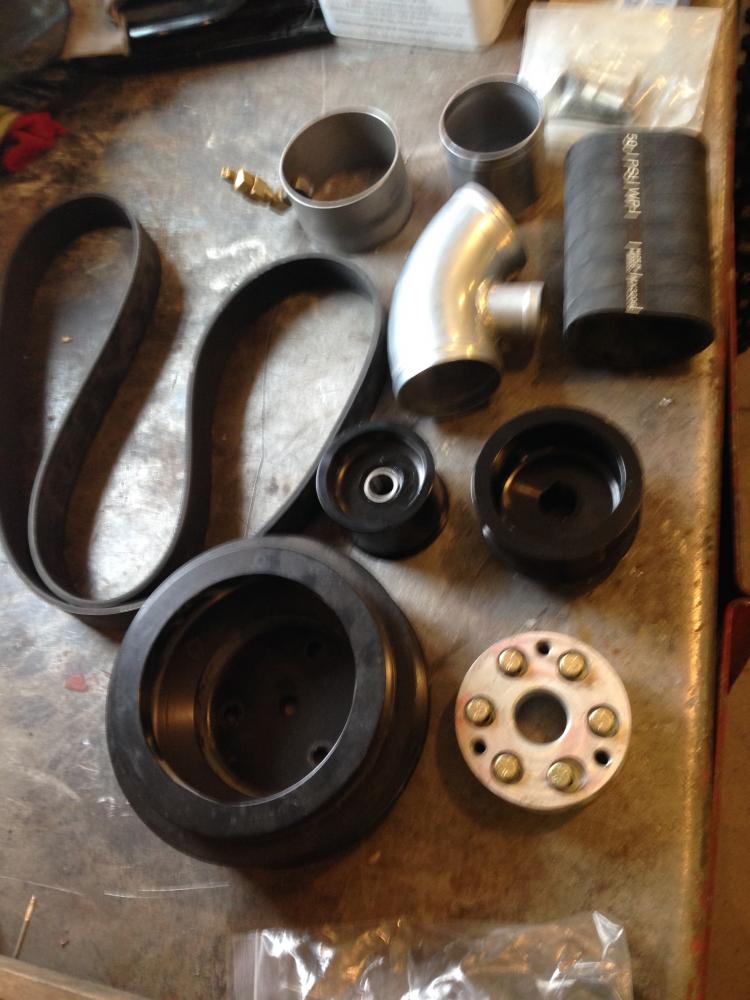

Sorry mike I couldn't add pics through PM so I put them here.
Here are the parts I have left.
This also a pic of when I had the 440 in the car.

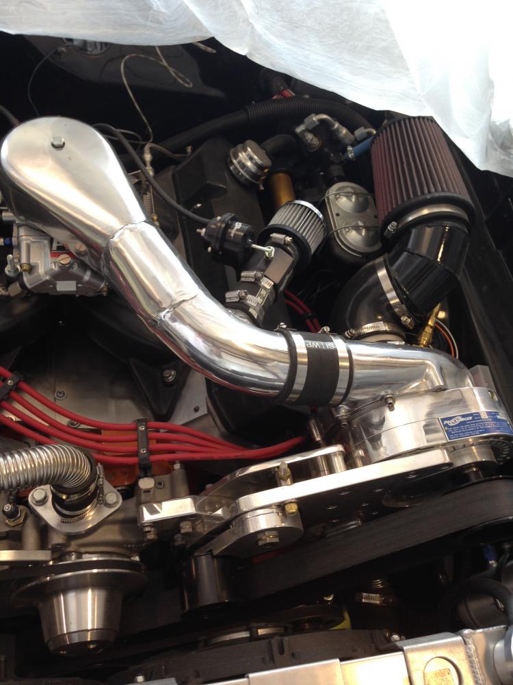

A few pics of the set up.
