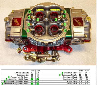

I have been logging my Jet/Bleed sizes and A/F info. The QF950 is very tune-able. You will like it much.
Wow! that's great! Thanks man!
