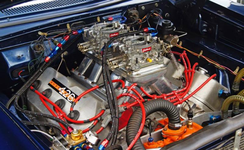

So,
i'm finally fed up with trying to get these dual quad 750 Eddies tuned. I love the look and attitude of the duals but i know this combo is killing my drive-ability and top end power. So they're going along with the INDY ModMan intake. What i'm replacing it with is an INDY 360-3R intake and a Quick Fuel Race Q-950. I'm thinking i'll pick up at least 50hp. Quick Fuel seems to be a great company to work with. I gave them my engine and drive line specs and they're gonna set the carb up and engine run it before they send it to me. They said they're pretty much dead on out of the box 90% of the time.

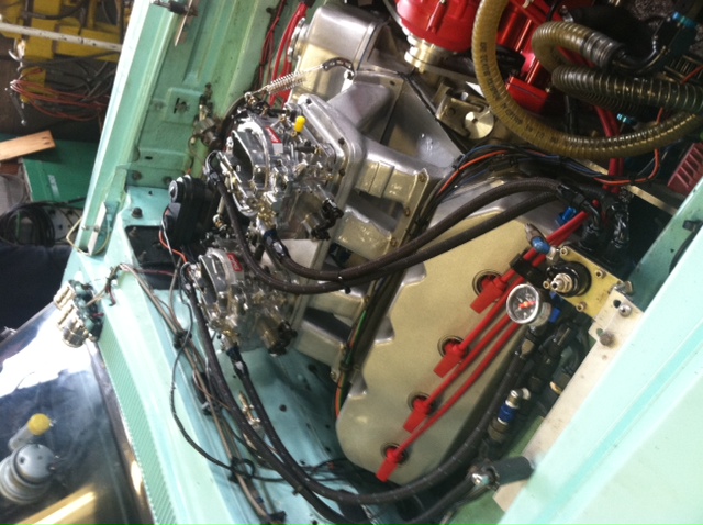

not sure where your problems are but I love my dual edelbrocks setup on my indy max wedge intake and tunnelram . Care to tell me where the issues are?
I have such a low vacuum signal that the Eddies won't respond to idle mixture adjustments and it's not very street friendly. I'm running a progressive linkage and right before the second carb kicks in it gets lean and surges then when the second one comes on it gets fat and stumbles. I've tried running them direct and then it kills throttle response. I tried running two 500's which helped throttle response but then killed my top end HP. Went up to two 750's and got the top end back but killed throttle response. What is really killing the power is the intake. I'll gain 40-50hp by just ditching the ModMan and i'm not cutting any holes in my hood for a tunnel ram. If you know of anyone looking for a ModMan dual quad set up with 750's and set up to fit on Indy 360-1 rectangle port heads, let me know. I've got one for sale.

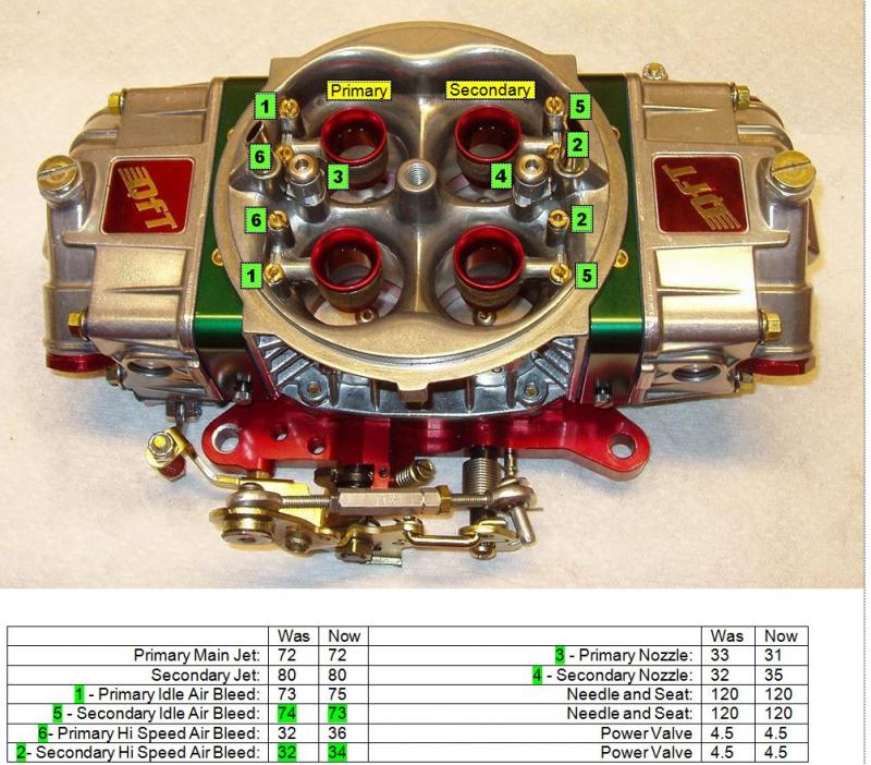

I have been logging my Jet/Bleed sizes and A/F info. The QF950 is very tune-able. You will like it much.
Wow! that's great! Thanks man!

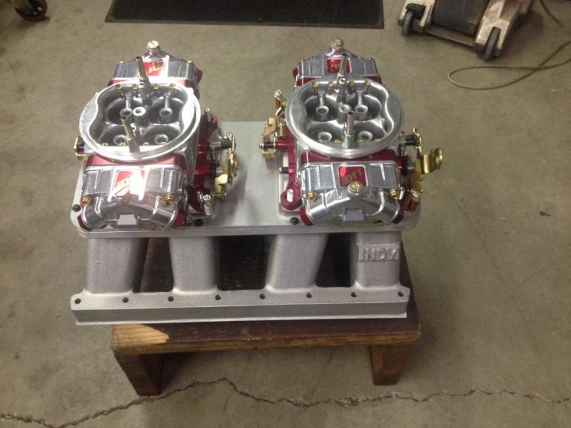

I have a Indy T/R and a pair of 950's going on a 572 HEMI that made 895 with a RBRE crossram with two 770 vac carbs We'll see if these QF and intake makes a difference
Brian
