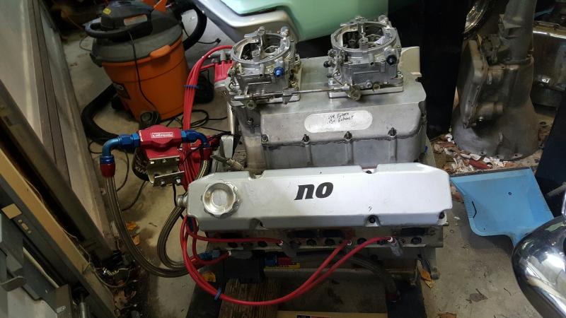

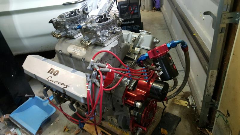

I decided to pull the tunnel ram off and put back the indy crossram with the 2 Carter 750 AFB carbs and see how fast I can get it. This is a new build that I tore apart and rechecked all the mistakes the old engine builder screwed up on.
I'm glad I didn't sell these carbs and held on to them.
